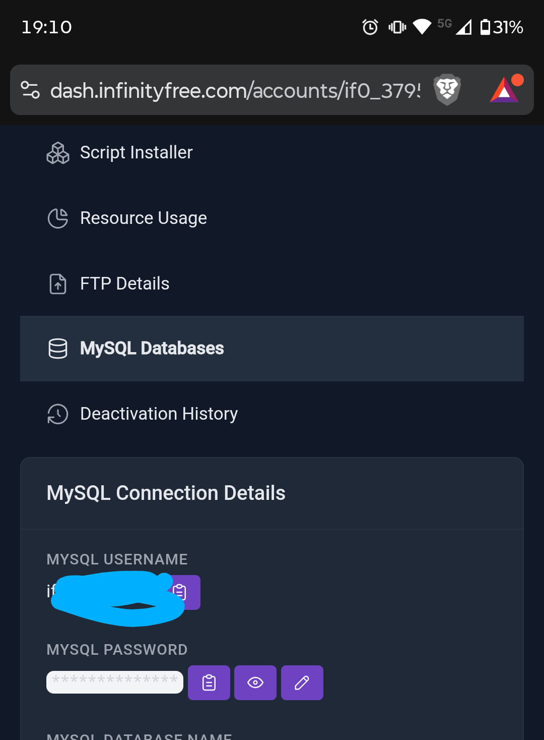

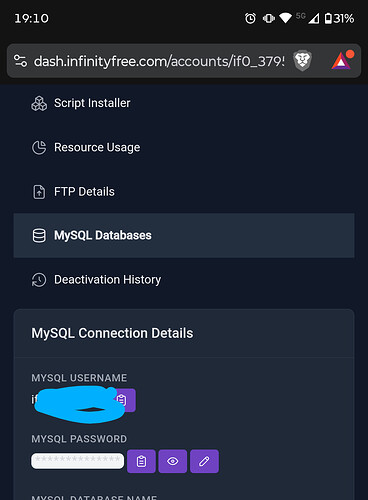

I copied the separate MySQL password directly from the MySQL Connection Details page and updated the application. The error remains:
mysqli_sql_exception: Connection refused
All connection details now exactly match the MySQL Databases page. Could this be a problem with SQL303 accepting connections from my hosting volume?

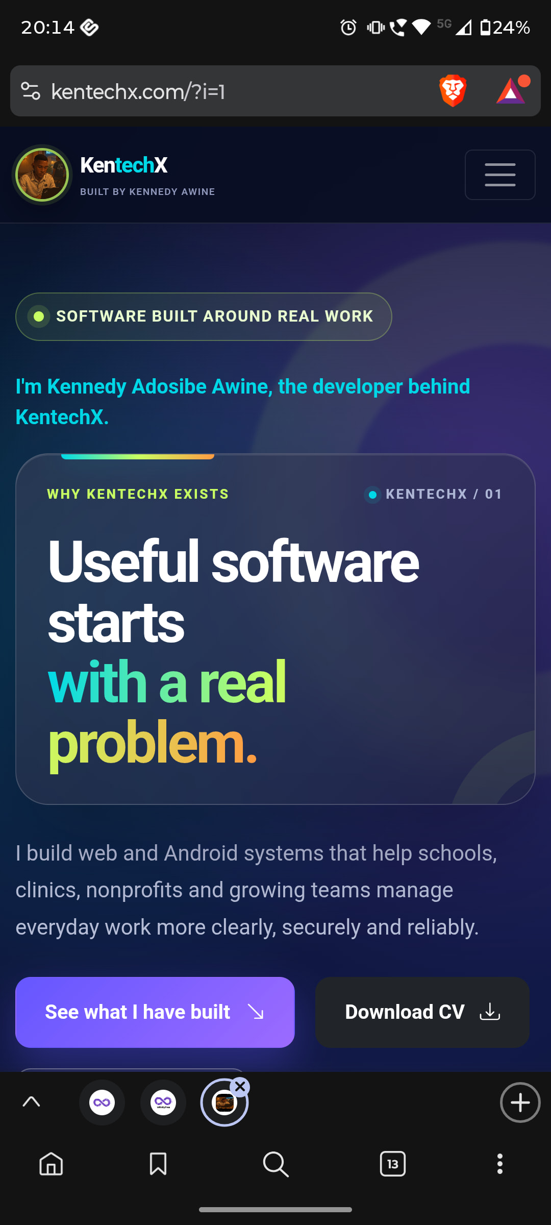

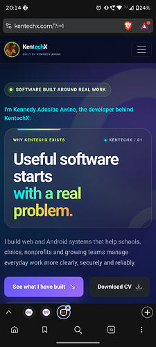

Can I check where you’re setting the error because your site looks to be working to me
