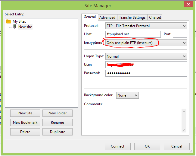

@Admin said:
It’s good enough as a workaround, but not as a solution. Solving the issue would mean everyone would be able to connect to the FTP server securely. Since you said you “solved” the issue, I had hoped that you would say “software X version Y on device Z has this issue, and if you configure A and B, then you can setup a TLS connection”. So I was slightly disappointed.
Yes I agree this is temp. solution and FTP connection not secure, but the host server address is of http://ftpupload.net not https://ftpupload.net that is why we have we have to disable TLS.
One more thing this issue is causing on Fillzilla as I mentioned, but the Version of Filezilla don’t matter’s because I’ve tried Some Older versions as well as newer versions but the issue persists, so I though their might be and issue on server side not in software and I thought not to mention any specific version of software.

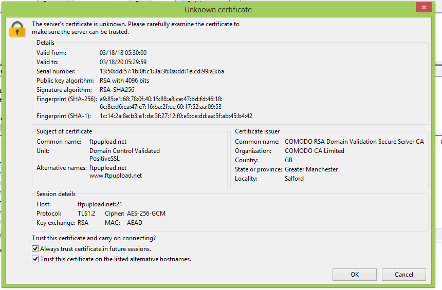

As Admin said: either on your computer, your own network or your ISP is causing the issue due to this unknown certificate.

That popup is completely normal, it just lets you double check the SSL certificate. And since there is no red text, it means there are no issues and everything is safe. So you can simply click OK and proceed with the connection. Why FileZilla doesn’t accept the valid certificate automatically is beyond me.
