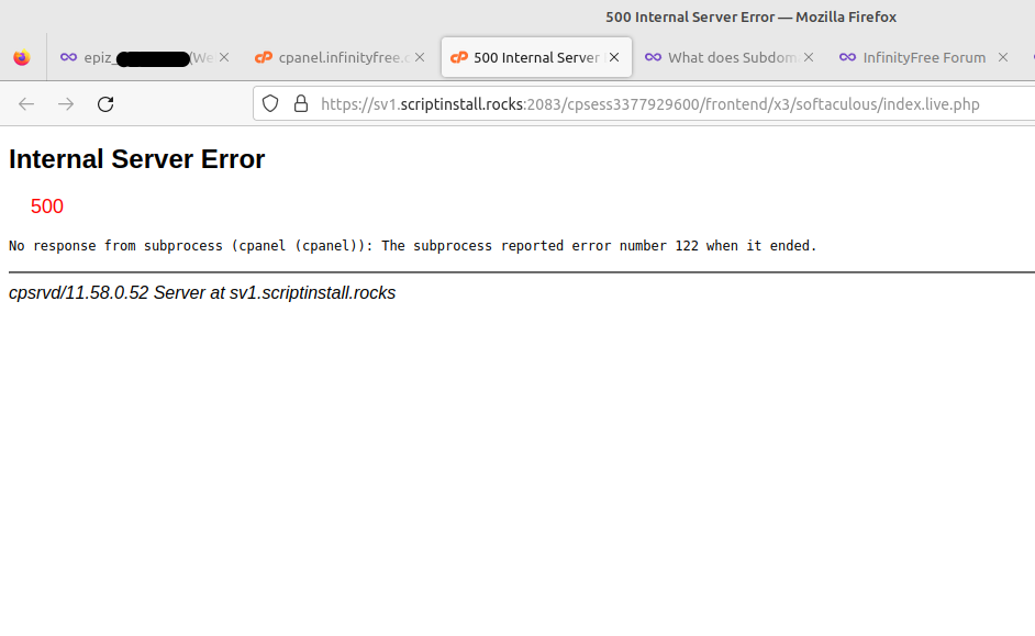

@Tapas2k7 , is this your first time seeing the error? If so, the server may be overloaded, or undergoing maintenance. Please try again in a few hours and let us know if the issue is still occurring.
This could be a problem with the Softaculous server itself. If that’s the case, there is not a lot you can do.
But you may also see this error if your account has reached it’s inode limit. You can view the inode counter in the control panel, where it’s listed in the sidebar.
Please note that the inode counter is only updated once every 8 hours, so if you just uploaded files or installed new software, the inode counter may show a lower value than your actual usage.
My inode is 99 % (29719 of 30019). It was working fine with this 1 months ago. I have not made any changes as I have not logged in around 2 month or may be more.
Just checked the file manager. My last change was made on May 23. It was working fine then.
If possible dlt some files…! Which will free some in nodes…
Dnt check immediately after dlting files…! It will take some time to update in nodes status so try after 12hours atleast
If you’re at >99% inode usage, I’m pretty sure the problem is caused by hitting the inode limit.
Even if you don’t make conscious changes, it doesn’t mean they aren’t happening. Complex software can make file changes on their own, such as automatic updates, or the creation of temporary files. If you’re that close to the limit, it’s very easy for such background changes to push you over the limit.
As suggested by @Admin and @HELPINDIA I have deleted some files and voila!!! It works again almost immediately.
Learned a new thing.
The problem caused due to above 99% use of inodes. Deleting some files freed some inodes, and Softaculous Apps Installer worked again.
