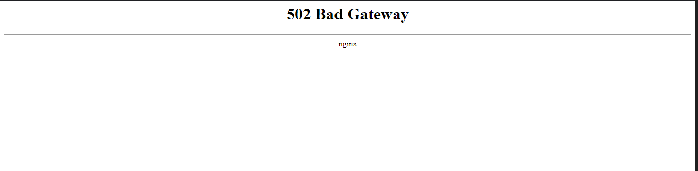

This error is also a direct connection error between the system and the database.
Wait, how do you know that? A 502 error could mean many things, how do you know that is the issue?
Because it’s just giving this error on this system that this server, so I know. Because others who developed the system on other servers, are working normally. Therefore
So how do you know it’s the database?

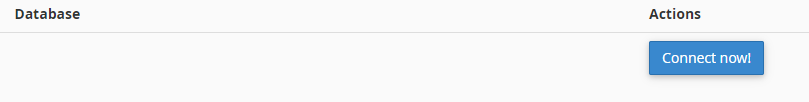

Again the database disappears from the server, as in the image above
This problem is recurring this month, the database disappears from your server and then reappears…

The error only happens when the database does not appear on your server, it looks like this, like this in the image, just connect now
That’s why on my site I can’t find the database
