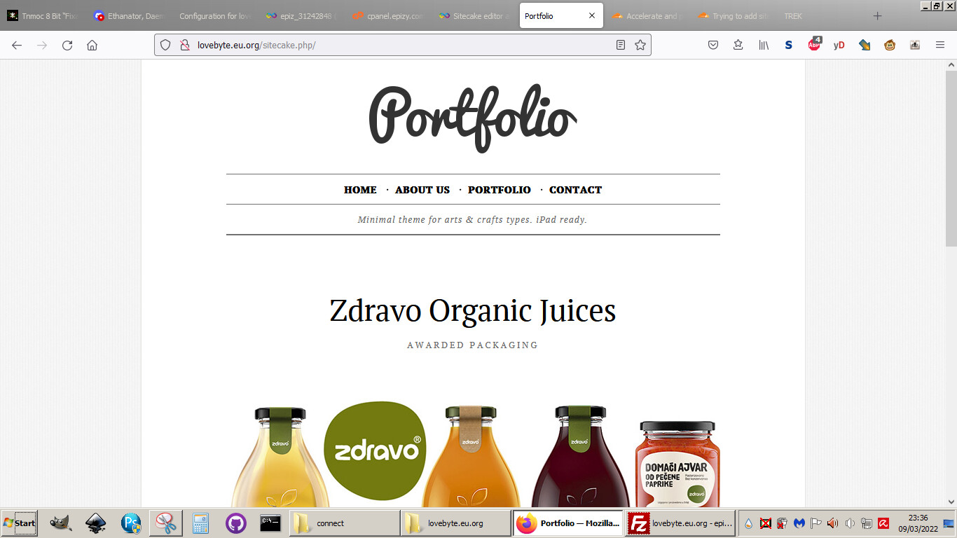

Hi, I installed sitecake from softaculous onto http://lovebyte.eu.org/sitecake to test it out but the admin doesnt allow me to login and instead just shows the website with broken images
Is there some configuration I need to edit ?
Thanks
This is the admin page

here try the admin login http://lovebyte.eu.org/sitecake/sitecake.php/
All external files return a 404 error. Check yourself in the Dev console.

well I fixed the 4 html files as suggested and this fixed the image issues but still the admin login / editor isnt working and just shows the regular page

http://lovebyte.eu.org/sitecake.php see if you get the admin login page
nice, I love 404 errors :pleading_face:
if youre getting a 404 then there really is something weird going on as it is loading for me even after clearing the cache except i still dont get the admin login
