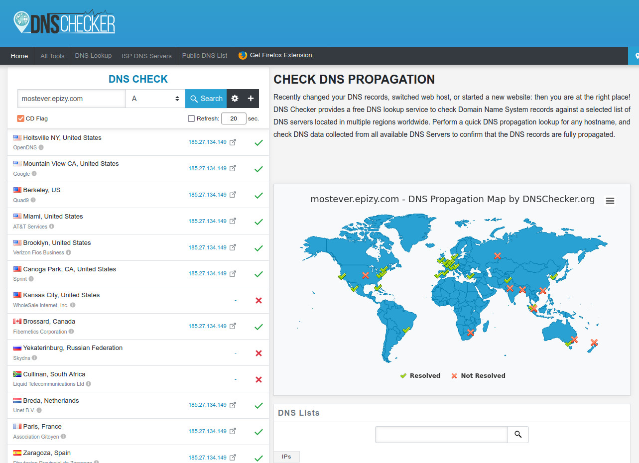

Possibly, this might be the issue as your website is working fine for me but using DNS checker I found that your website is not accessible at some other places.

Yeah, my site: www.mostever.epizy.com has been doing this for several days. Never know when it will be up or down or who will be able to see it. Makes it kinda difficult to test the changes to my theme. Oh well.
So the A record keeps changing by its self, or are you removing it and re-adding it?
Only thing I did was: sign up for an account, choose name, upload files, apply for ssl, add ssl, and add other site files. throughout this process, the site randomly goes from available to unavailable. At one point the https was available when the http was not. Would get different results when using cellular data rather than my isp.
In any case, I will likely remove everything and start from scratch.
Maybe wait a day and see if the A records is consistent.
There was an outage, it has been confirmed and has not been fixed yet. Some of the nameservers report the correct information for your domain and others don’t.
Instead of starting from scratch completely, you could also try removing the domain from the account and then add it again. That should force the settings to be updated and bring your domain online.
