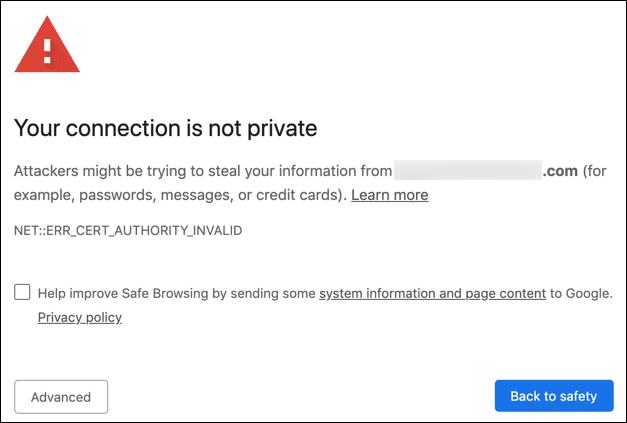

do you know that if you get an | ssl | certificate , that visitors to your website, will see something like this ? …
proxy-image
