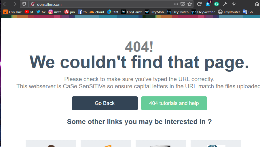

I’m getting a 404 error message when I just try and type domallen.com .
I have to type www and /index to load the site. How do I load the site without the www and hide the file name extension. I’ve tried this with htaccess but can’t get it work properly.

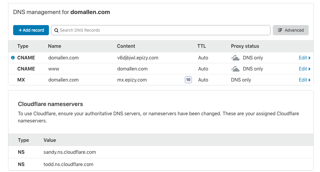

hmm, you’re using CloudFlare. You can add CNAME for your main domain as described here:
DO NOT USE THE CPANEL INTERGRATION
This is the proper way (the cpanel thing is broken)
Change your name servers to cloudflare
Set up cloudflare through the dashboard
Add these cname records at cloudflare:
Content: your main domain
Content: @
Make sure to click the orange cloud until it goes gray
Pros
Bypass cookie / javascript checks
Full DNS management
I hope this helped
I forgot this, but ANY DNS records need to be added through Cloudflare, not vPanel (thanks…
What do I need to put for Target?
8 random-character main domain. You can find it in client area
Sorry I’m a bit confused, the client area where?
domskial:
app.infinityfree.net/accounts/
At Login to your account - InfinityFree , select the website you mentioned here, and under Account Details, there is a section that says ‘Main Domain’. It will look something like this: xxxxxxxx.epizy.com.
In the Cloudflare DNS Section, click add a new record, change the type to CNAME, put the host as @ and the target as the domain found in the Client Area.

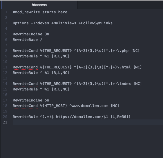

If you want to remove file extentions, add this to your .htaccess code:
Options -Indexes +MultiViews +FollowSymLinks
RewriteEngine On
RewriteBase /
RewriteCond %{THE_REQUEST} ^[A-Z]{3,}\s([^.]+)\.php [NC]
RewriteRule ^ %1 [R,L,NC]
RewriteCond %{THE_REQUEST} ^[A-Z]{3,}\s([^.]+)\.html [NC]
RewriteCond %{THE_REQUEST} ^[A-Z]{3,}\s([^.]+)\index [NC]
and if you want to remove www
remove www
RewriteEngine on
RewriteCond %{HTTP_HOST} ^www.domallen.com [NC]
RewriteRule ^(.*)$ http://domallen.com/$1 [L,R=301]
change the http:// bit to https:// if you have ssl

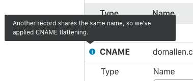

I also have this CNAME flattening thing (see screenshot) does that matter?
And I’m still getting a 404 error, argh!!

Press on the grey cloud to make it orange cloud for both CNAMES
Oxy
February 11, 2021, 1:21pm
15
for a certificate you have to be inside the orange cloud
https://community.cloudflare.com/t/step-3-enabling-the-orange-cloud/52715
And why do you still have 404
the problem is in your .htaccess
which undoes the default .htaccess
which seeks to serve index.html as the home page
You delete the extension and it can’t find that file

FlutterHoney said it needed to be grey?

RewriteEngine on
RewriteCond %{REQUEST_FILENAME} !-d
RewriteCond %{REQUEST_FILENAME} !-f
RewriteRule . index.html [L]
