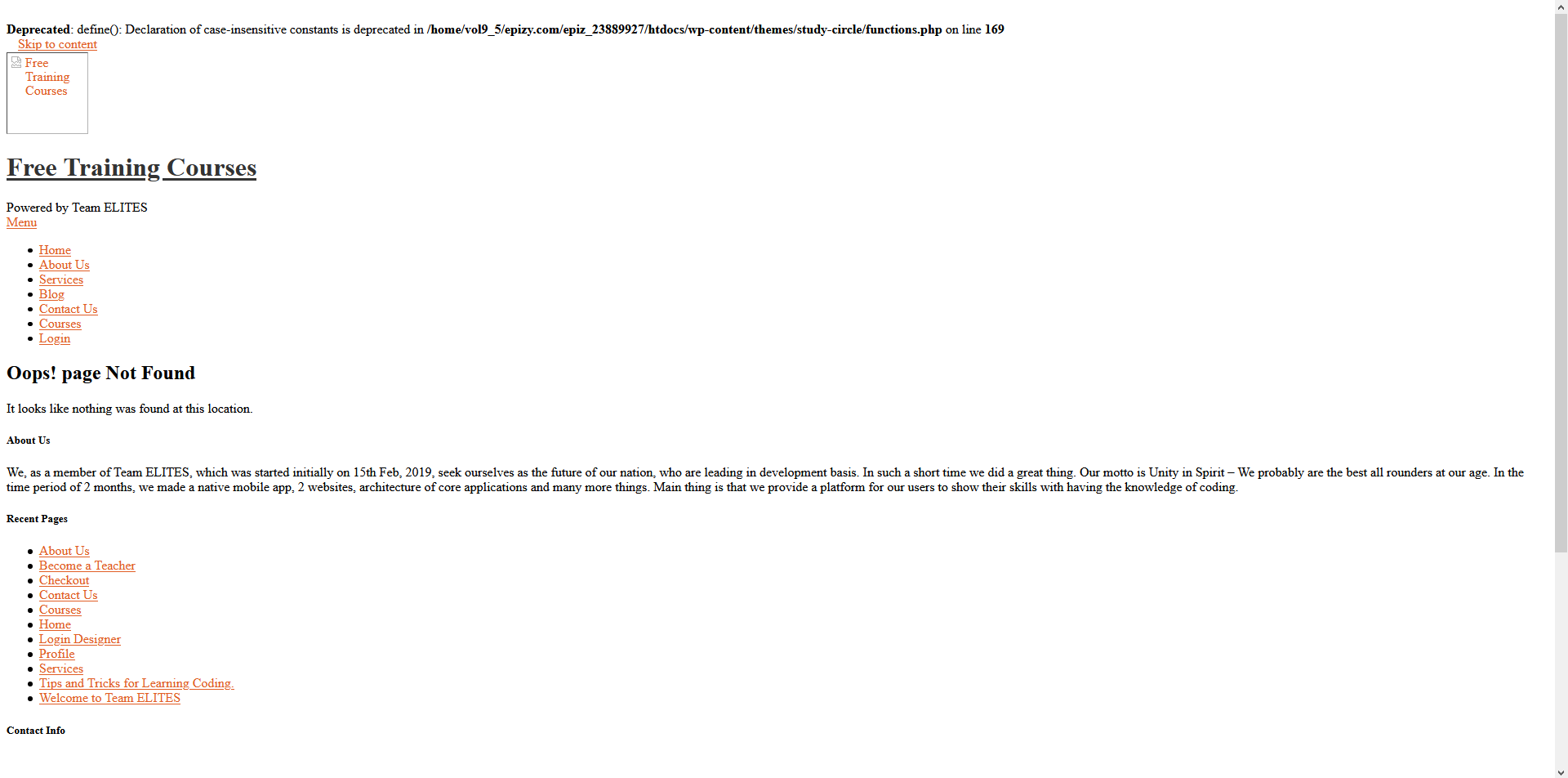

Wp-Admin has error 404, page not found.
After a ton of waiting it loads but it looks broken

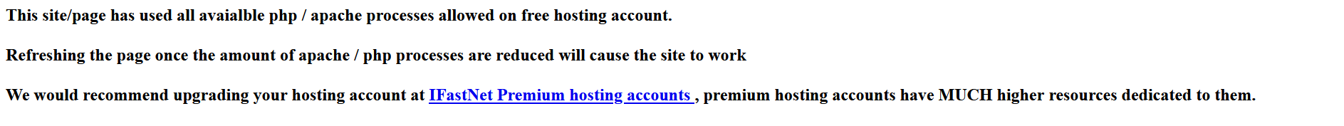

Got this new error message by adding /?i=1 at the end
I know it has infinite problems, that’s why I have infinity support here! I opened this website after a month. It worked good previously.
Welp, it seems that whatever was sending that redirect must have been a complex PHP script. Because that explains the “used all available php / apache processes” error, and now your account being suspended for hitting both CPU and Entry Process limits.
The entire situation seems like a case of botched .htaccess rules, WordPress website URL settings and possibly some plugins. So here are a few suggestions for things to do when your website comes back online:
  • Get rid of all the .htaccess rules and redirects. Make sure only the WordPress core .htaccess rules are present: htaccess – Documentation – WordPress.org
  • Enter your phpMyAdmin, go to the wpXXX_options table and check the home and siteurl options. Make sure those values look good (that they match and contain a correct URL).
  • Delete any plugins related to changing URLs or setting redirects. Multiple plugins which do the same thing or are just not working well can cause problems like this too.
  • Remove any redirects or website URL related settings from the wp-config.php file. You shouldn’t need them.
After doing all of the above, your website should be accessible again, if not over the URL it should.
If you’re looking for ways to do something, can you please explain what exactly it is you were trying to do? Maybe we can help you find a way to do that without breaking your site again.
