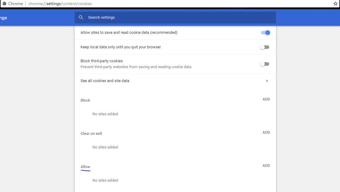

Maybe try to “whitelist” (add) your site to Allow Cookie (in Chrome).

@Admin All the Browsers that I’ve tested on are set to cookies allowed from the settings.
I don’t usually use vpn, proxy or data saving anything. I use incognito mode even on my machine all the time xD just to avoid deleting chache & cookies again and again. I tried everything at my end. My two sites are affected by this. You might think that my wordpress installation files have something infected but the thing is both the installations were done apart 5 months from each other and I didn’t even accessed it till this issue arised. I haven’t accessed the backend of that site in any manner so no point of that being affected later on. Is there any other possibility for the unnecessary ad popups? for desktop it is taking me to Cobalten.com and for Mobile it is something “ifrodorid” sorta…
