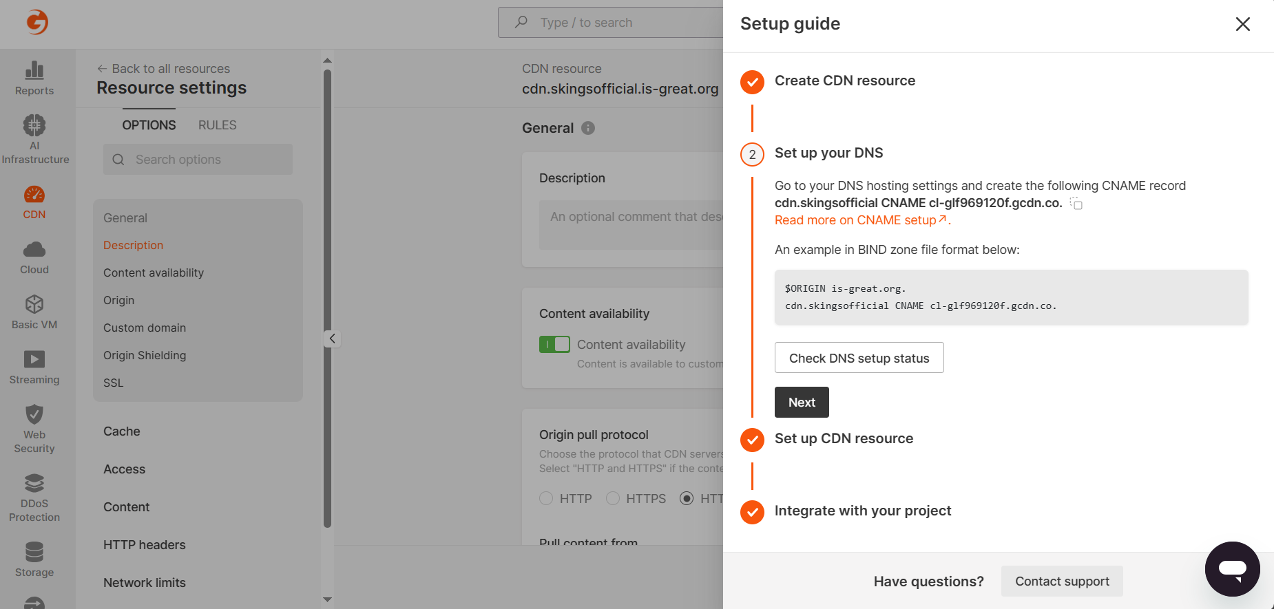

Okey. I will try to explain it.
on the first picture there is cname which I already configured

Edit: I think it’s either they don’t support subdomains, or my second prediction is something with the security wall in infinityfree.
This is expected.
skingsofficial.is-great.org loading resources from cdn.skingsofficial.is-great.org is not allowed
CORS is not allowed on free hosting
