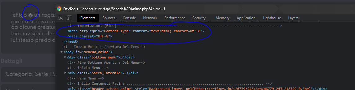

The utf-8 charset doesn’t work.
Screen
What do you mean it “dosent work”? Your site looks fine to me.
The info page dont take the accented letters. Try to scroll down in the index and then click on bleach.
Those meta tags make the code use the charset you defined.
But it’s probably the charset of the file itself that’s wrong.
Use your text editor to convert the file’s charset to UTF-8 and re-upload it to the server.
Using VS code, just open the file and change the encoding on the bottom bar:

It is arleady in utf8. I get the data from the database. If i insert the text in the normal html, it works.
Hum! Than it’s most probably the database collation that is not right.

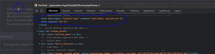

I arleady recompiled all columns with a normal ctrl+c and in the database the accented letters are ok, now i post more screens.
