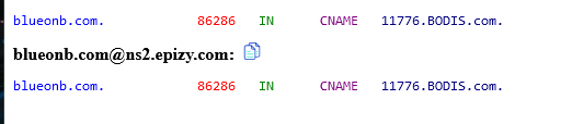

I have a problem, i have registred a domain name on amen.Fr and i have host my website on infinityfree but now my website show ads blueonb .com and i don’t understand why, i have check the dns but nothing. Can you help me please ? Thanks
And when i add a subdomaine like blog.blueonb .com, there is the page of suspension of ifast but my account isn’t suspended
Thanks for help

In this case, it seems like you setup everything correctly, but something went wrong on our end and caused the Bodis record to be set for you domain instead of the right data.
Seeing how this is a new account, you could just remove the domain from the account, and either add it back to this account or create a new account with the same domain. Either way, if you try adding the domain again, it should generate the correct settings.
