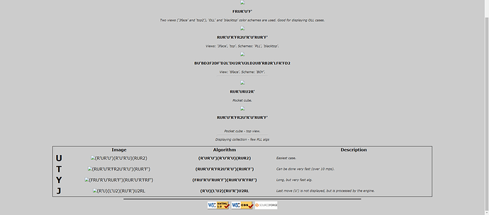

The images are not being generated. I’m sure it was working before. I did not change anything in the php code. I think I’m using deprecated php syntax that is not working. I’ve enabled error displaying in the console and I can see this error:
GET [http://2x2.great-site.net/scig/scig.php?desc=pocket/PLL_down&data=RUR] Warning : Undefined array key “debug” in /home/vol11_1/epizy.com/epiz_27863834/htdocs/scig/scig.php on line 70
Warning : Undefined array key “use cache” in /home/vol11_1/epizy.com/epiz_27863834/htdocs/scig/scig.php on line 76
Warning : Undefined array key “width” in /home/vol11_1/epizy.com/epiz_27863834/htdocs/scig/scig.php on line 106
Error: Width is incorrect
I’m using Spyc to load yml files. I think it is not working correctly. Can anyone help me fix this problem?
Thanks

I believe it does, or I would not have asked for it to be shared. The script throws an error saying that the width property is missing; that property is loaded from the YML file. Before assuming something is wrong with the script, let’s check the structure of the YML file first.
Hi ChrisPAR,
I have solved that as a part of the library upgrade, the yml file syntax from the original package is problematic (with mixed tabs and spaces here and there) as well as the decoding process not parsing the file correctly (not an assumption, it is what it is). That can be fixed by manually finding and replacing the syntax, replacing spyc will get the yml loading part to work.
Meanwhile, the bigger issue is that scig is very poorly coded in terms of syntax and code structure, therefore when upgrading to PHP8, many bugs occur here and there due to (originally intentional) missing brackets, poor formating syntaxes, etc. In addition, both spyc and xtpl in the includes folder are both outdated from the distribution so I have to manually update those to clear another batch of bugs.
To save time, I have revamped the library just now and cleared all coding obstacles that involve formatting and syntax issues. However I didn’t go in-depth into studying the algorithm for the Rubik’s cube and Pocket cube engines, I intend to let robal1991 resolve that part as he/she might be more familiar with the subject.
This is the latest error message after resolving all items in the php_error.log:
Error: Invalid puzzle state (probably engine error) ((FRU, FRU))
Getting the algorithms to list means that the yml loading part worked as expected, I’ll try to see if I can figure out the algorithm and get the images to generate as well.
Cheers!
Thank you very much for help. I’ve updated the code to PHP 8.2 and fixed formatting in the yml files and updated spyc to newer version. It is now working as before.
Again thanks! :slight_smile:
