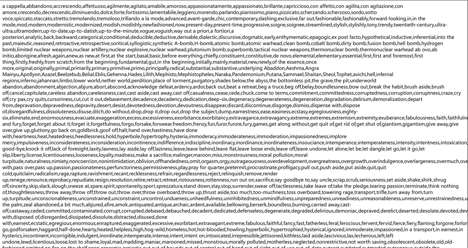

I’m literally reading a file straight from the file system and outputting it directly to the browser, yet, the new lines are seemingly being turned into spaces.
File: https://yusi.free.nf/data/mobythes.aur
PHP File: https://yusi.free.nf/data/extract_terms.php

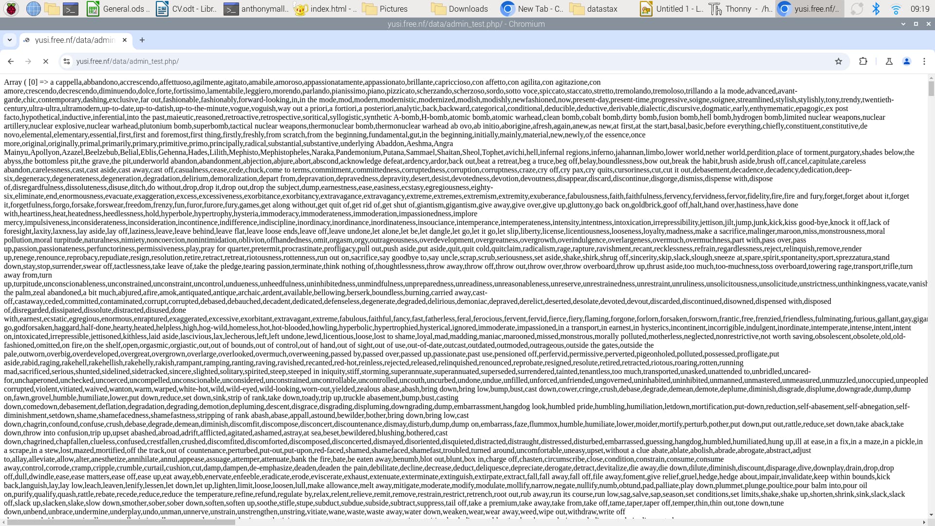

Tried with file() as well:
https://yusi.free.nf/data/shape_terms.php
Code:
$file = file(‘mobythes.aur’);
print_r($file);
Notice how it doesn’t create a new array element for each line.
Something is off. I don’t believe this is how it is supposed to be.

The new lines are not there. Compare these to the original file:
If the new lines were being processed correctly, you would see breaks in the first image you posted, and multiple array elements in the second image you posted.
See how there are breaks? Compared to the images you posted?
Now I see this.
I’m sorry, but this is how PHP works. It’s expected.
To be precise, that’s more like browsers doesn’t like raw line breaks in HTML content, so they won’t display properly.

https://yusi.free.nf/data/admin_test.php/
$file = file_get_contents(‘mobythes.aur’);
$lines = explode(‘\r’, $file);
print_r($lines);
