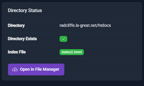

The other thing to check is in your dashboard, in the domain, you’ll see a box that looks something like this:
Make sure you’re working in the right htdocs folder. I know I’ve made that mistake before
