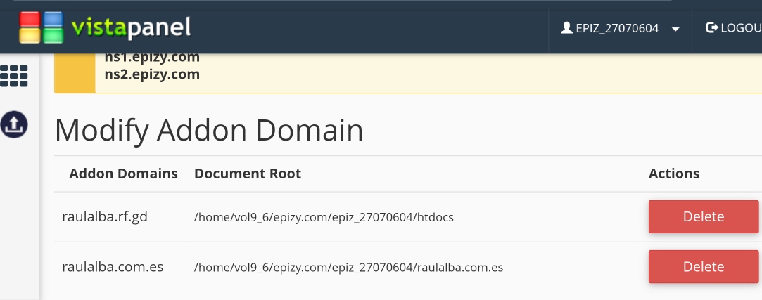

But my own domain raulalba.com.es doesn’t point to htdocs directory (as you can see below) so it doesn’t open the site.
Addon domains information is:
raulalba.com.es /home/vol9_6/epizy.com/epiz_27070604/raulalba.com.es
raulalba.rf.gd /home/vol9_6/epizy.com/epiz_27070604/htdocs

This is what I have at Addon Domains.
Could this be a solution?: Move the content from /epiz_27070604/htdocs to epiz_27070604/raulalba.com.es/htdocs
Would It work…?
Yes it would

Thank you for your response. I tried the method of moving the content from /epiz_27070604/htdocs to epiz_27070604/raulalba.com.es/htdocs and it worked.
