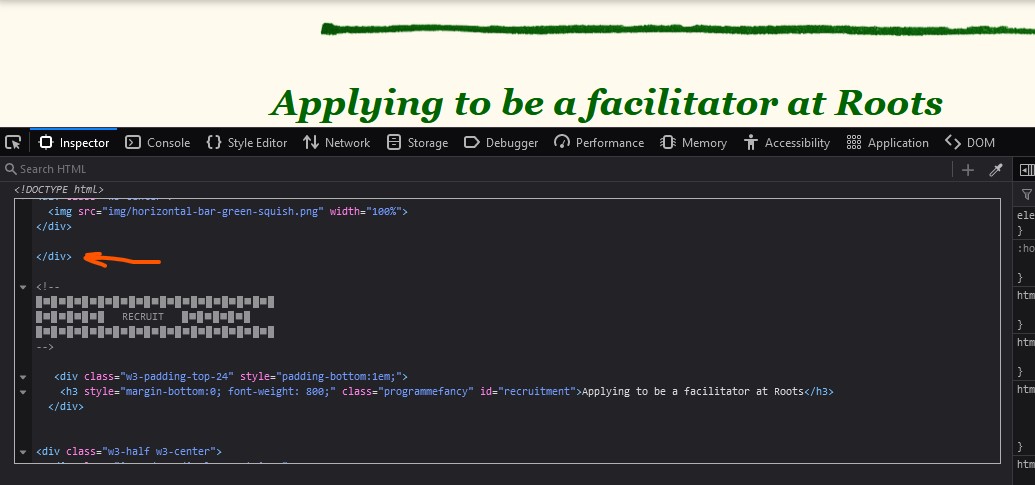

I see it now:
Unfortunately, I don’t have access to dev tools currently, so, I cannot help much other than look at the source code.
you probably get that impression when you compare the subtitle with this line above (separator)
but everything is equally wide - if we look at the dimensions of the container

delete this closing div (or drop it below after this title)
you closed the container but after it… you added a new title and text ( so the text goes a little more to the left - but does not overflow the container)
corrected
be sure to review the source by pasting it here and correcting errors

you actually miss 2 or 3 </div> which you need to close
And it’s up to you to orient yourself in your code and put the sections in their appropriate containers like <div class="w3-content"> and pay attention to where you want it to end (probably after the footer).
try to replace all source with this inside code.txt
code.txt (22.0 KB)
I fixed some <p> and <div>
I did not correct the other mistakes but primarily for the problem stated in this topic
