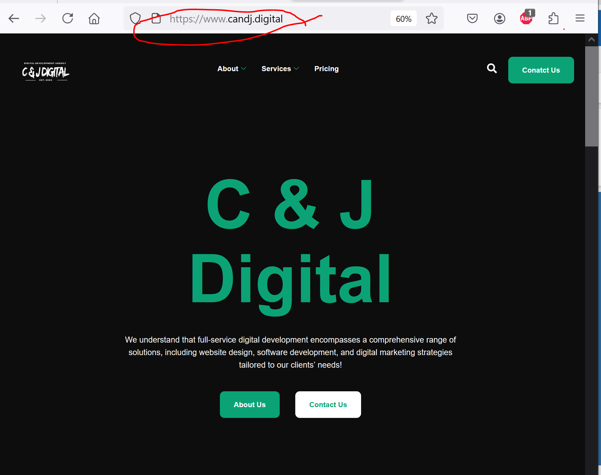

@anon3721532 ,
I can see your website in Firefox:
