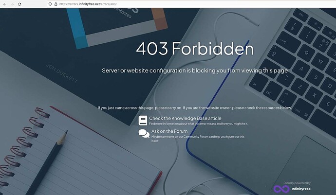

issue is not solved it is showing 403 forbidden. But can i install WordPress on my site? is it possible to install ? and if it possible can this solve the 403 forbidden issue?
(newsnewest.com)
(403 forbidden server or website configuration is blocking you from viewing this page )
(i want to solve this issue but the infinityfree online file manager is not working. But can i install WordPress on my site? is it possible to install ? and if it possible can this solve the 403 forbidden issue?
Most of the time, the 403 error is caused by simply not having a valid home page file uploaded for your website.
If you just added the domain to your account and haven’t uploaded a website, this is completely normal. And not having a website uploaded is the reason you see this error, and uploading a website fixes it.
So yes, you can install WordPress, it’s definitely possible to install, and probably installing WordPress will actually make the 403 error disappear.
