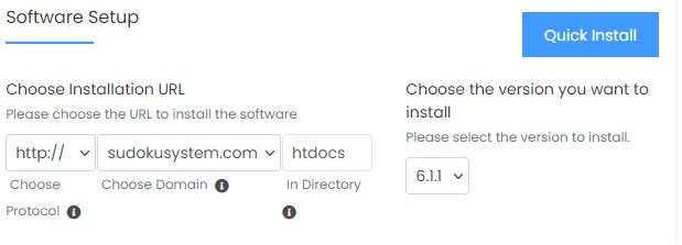

I have done this exact scenario before, so this time I put in htdocs into the installation URL.
WordPress Install, Default Database, with Installation Install URL as...  sudokusystem.com with directory...  htdocs.

So that just installed WP into htdocs/htdocs, until the 95% sticking point.
