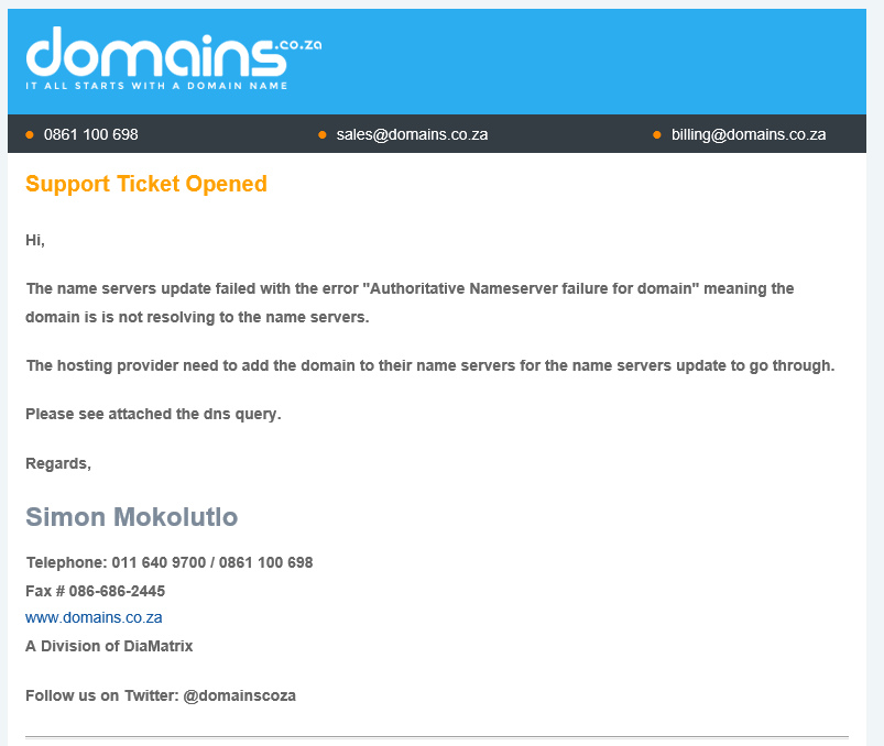

The company that i registered the domain with says “The hosting provider need to add the domain to their name servers for the name servers update to go through.”

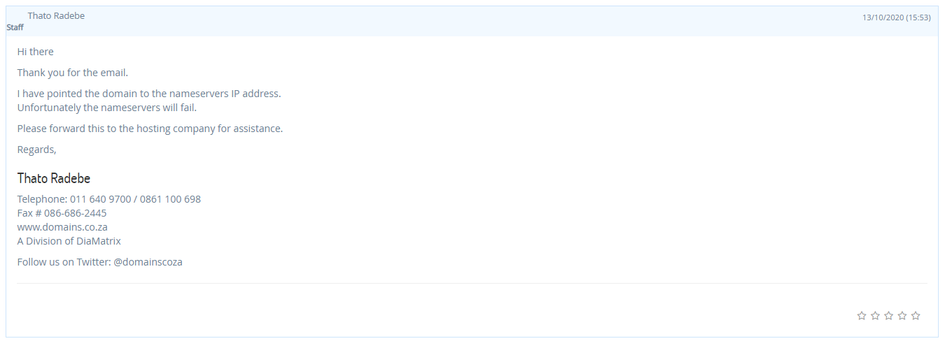

So attached is the screenshot for the domain registrar plus the email screenshot.

I’m sorry, but no amount of waiting is going to fix this. You’re experiencing the issue described in the article @anon77371365 shared.
I’m not aware of the strict nameserver validation being an issue with the .co.za extension itself, so it may just be something that your domain registrar is doing. If so, you can try to transfer the domain to a different registrar which doesn’t do this check.
Checking a few domain names which were added successfully shows that 1api.net is a popular provider which does let you add the domain.

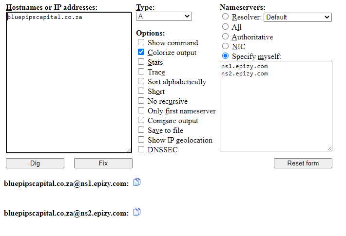

The nameservers for InfinityFree are ns1.epizy.com and ns2.epizy.com, as you can see everywhere.
The DNS records for InfinityFree depend on the account the domain name is assigned to. And that account information is generated when an account is created.

“Unfortunately the nameservers fail” is exactly the behavior that’s described in the article we wrote and @anon77371365 linked to. It’s a known limitation which we can’t fix right now.
So again, my only recommendation is to use a different domain registrar. We will not skip our domain verification checks, and if your domain registrar won’t either, then you’re in a catch-22. Which is a loop that you can only break out of with a domain registrar that doesn’t enforce nameserver checks.
