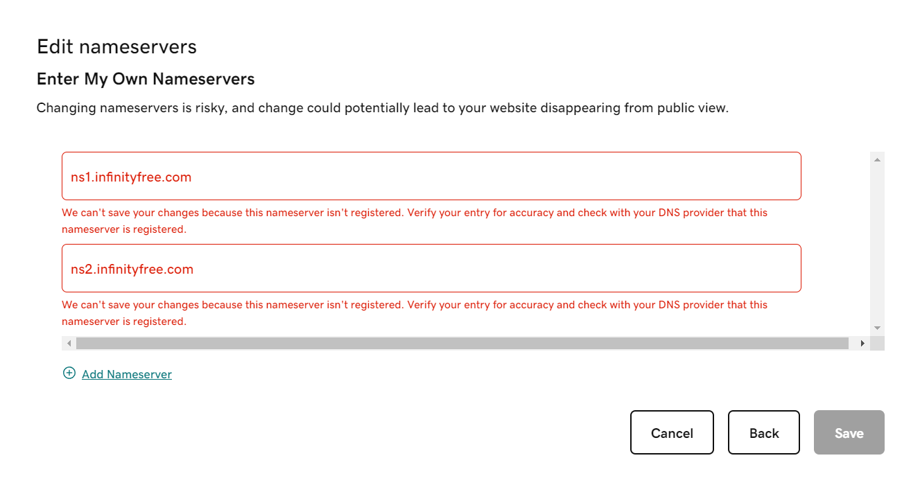

Namecheap says ns1.infinityfree.com is not registered
Namecheap is not allowing me to update nameservers to ns1.infinityfree com and ns2.infinityfree com

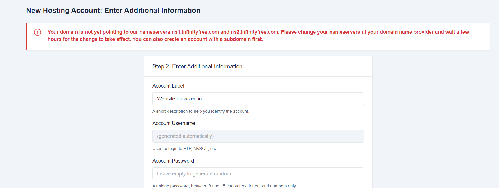

but still I am getting error while account creation here at infiinityfree saying domain not pointing to ns1.infinityfree.com and ns2.infinityfree.com
please help

this is showing

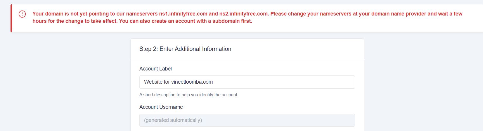

and this while account creation
Facing the same problem with godaddy too

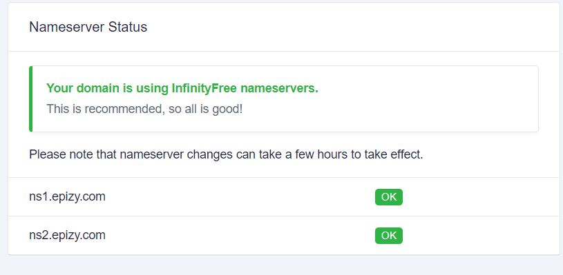

it shows this

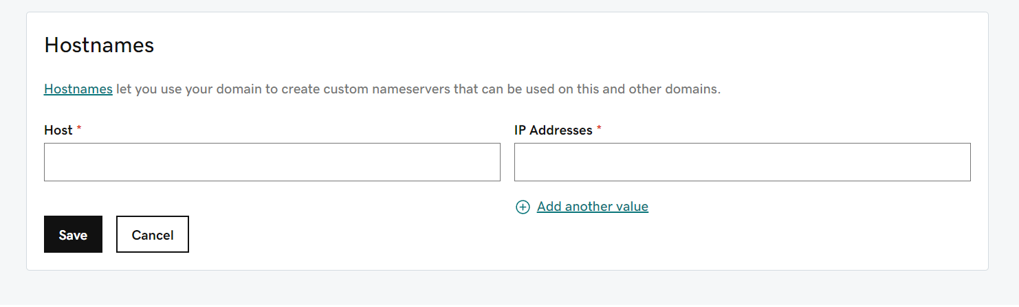

still facing the same issue, maybe i have to register this servername but for that I would need IP address, and I don’t know from where I can get it
