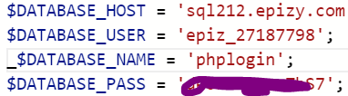

database names are [username]_[dbname]
Is this correct?image
It would be:
$DATABASE_NAME = "epiz_27187798_phplogin";
Still throws the error
No, your user is still epiz_27187798
But your database_name is epizy_2718798_phplogin
aah,ok
