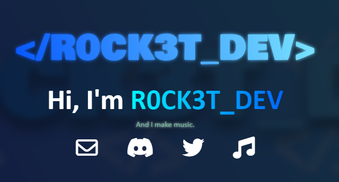

Both are working for me
Screenshot_2023-05-27-09-40-10-857_org.mozilla.firefox
Working!
