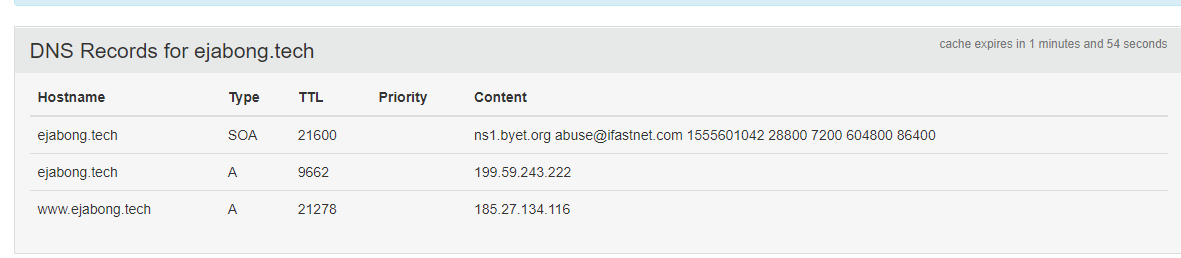

Most likely the effect of DNS Propagation:

The CNAME for bodis disappeared:
However, my link http://ejabong.tech still points to the ad page. I think it will be fine soon since the DNS record has just changed.

Due to this
Once A record for base domain is the same as www subdomain, things will be fine by then

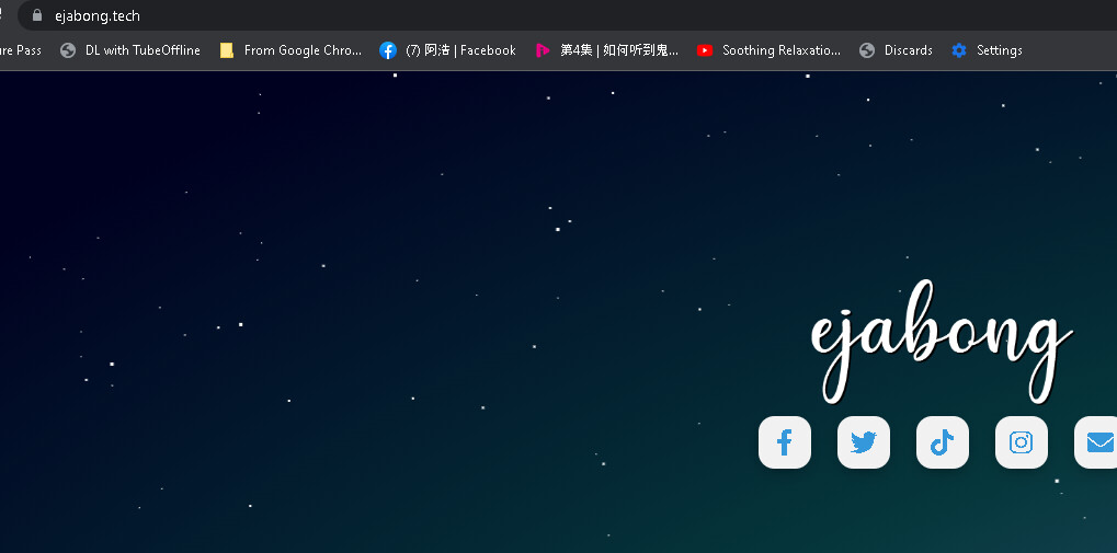

Thanks for your reply! It’s already resolved with the solution provided by KangJL in this thread.
