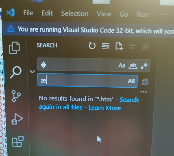

Thanks again, but my version of VSCode (x32) only works when I choose a single file from the list (folder)

I guess this is not the issue with x32, you can try open folder instead to see if you can at least see a file tree first, then right click on the folder to see if there’s an option to find in folder.
Cheers!
I think that was what I did. I got the list (tree?) and marked all files as shown here, and the result was as shown in my former picture (no results found).
