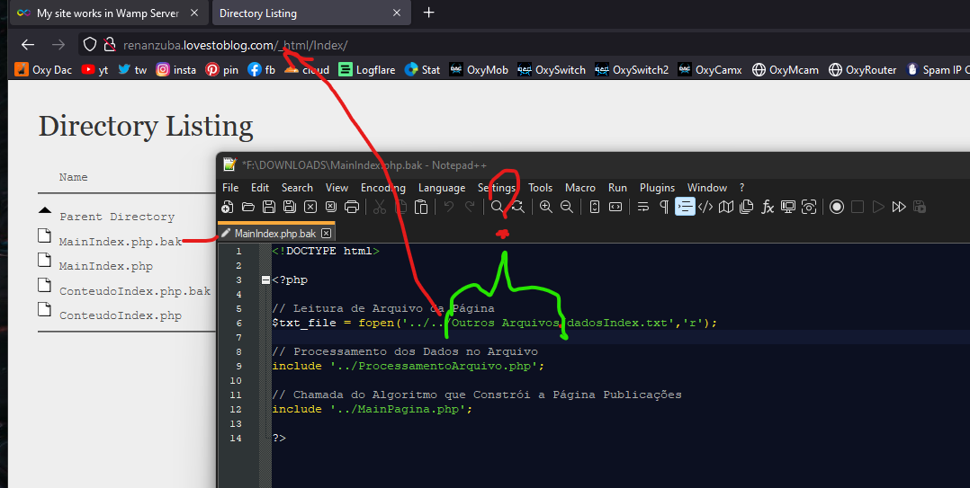

First thing first in my code is to split a .txt file, which is inside a project folder and is a data input. I think this is the problem: nothing happens because the file isn’t beeing read in the first moment. This method is working fine in my local server, but not in Hosting. Do you now how to solve it?

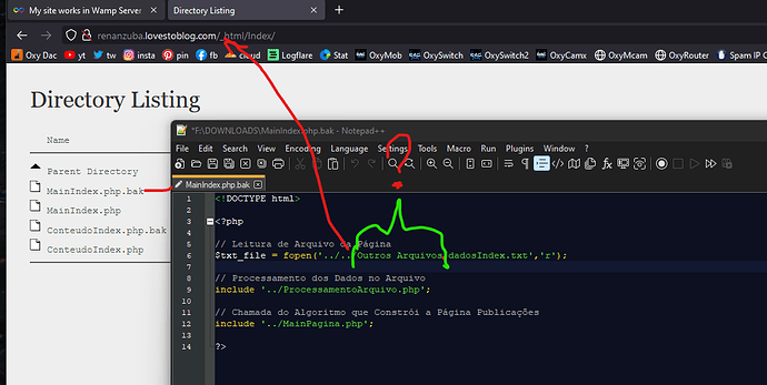

Is this path available (on server)?
What is the full path name?
If this path is referring to localhost, it will not work on this webhosting
This folder does not exist (green), and then neither does the txt file
In addition, do not name folders with space !
Even if the server serves folders with space in the name (without %20) some other code could break because of that, for example .htaccess .
How to Name Files/folders
For best results, you should only use the letters a-z, A-Z, the numbers 0-9, hyphens (-), underscores (_) and periods (.). Any other character could get you in trouble, causing the file not to load or the page to load incorrectly.
it is best to use lowercase letters, also Do Not Use Any Spaces.
P.S. delete all .bak files so that no one would look at your code
Thanks! The problem was the blank space! :grin:
