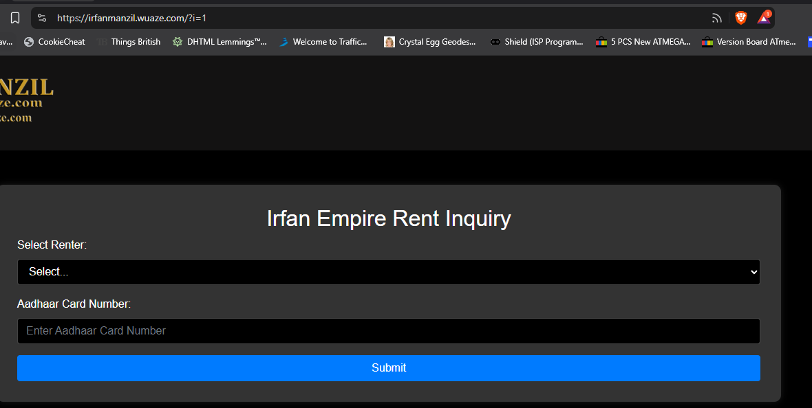

Looks to be working to me.
Please try a device on a different network, or a VPN to check if something on your network\ISP is blocking the connection
