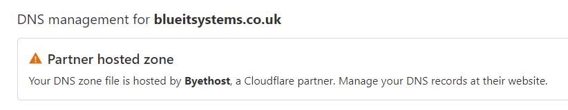

Email is working now but as I have turned off the the setup within cPanel for Cloudflare my domain has no SSL anymore.
Can you please help me how to manually setup my domain at cloudflare?
I have a free account with Cloudflare and my site is registered (see screenshot) but still the SSL is not working
.cloudflare1
To set up your domain on Cloudflare manually you need to delete the domain on Cloudflare’s dashboard first, by clicking on your domain, scrolling down and then clicking on “Remove Site from Cloudflare”, then add it again as a new site, select the Free plan, wait until all DNS records are checked and see if they are correct, then continue and change the nameservers to Cloudflare’s from your domain registrar’s nameservers management panel, and after that wait until the changes are propagated and see if your website works again after waiting until the changes are propagated.
