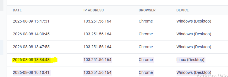

image Account detalis for admin only

This is a public forum. Whatever you post here is visible by everyone, and there’s a good reason the Admin have DMs off that is to prevent what you are trying to achieve here.
