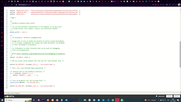

I have the same problem, when i try to upload media in a gallery of images. this is mi website, please help me i tried to put this custom value on wp-config :
define(ā€˜WP_TEMP_DIR’, dirname(FILE) . ā€˜/wp-content/temp/’); and make the folder temp in the route specifed but didĀ“nt work http://danportfolio.kesug.com/wp-admin/post.php?post=34&action=edit

Ok, I have done the steps you mention but I still have the same problem, additionally I noticed that when I press ā€œrefreshā€ to save the changes of something else I get the error: ā€œserver error (400 bad request)ā€ I also tried to open an incognito tab Yes you were working with old cookies but the problem persists. Please review it

I am also having this issue after doing the ā€œfixā€
Okay, I’ve tried this again but named the folder ā€œtmpā€ instead of ā€œtempā€. This time, editing the wp-config didn’t result in a white screen.
The fix has fixed installing plugins, but not uploading media and customizing the site.
