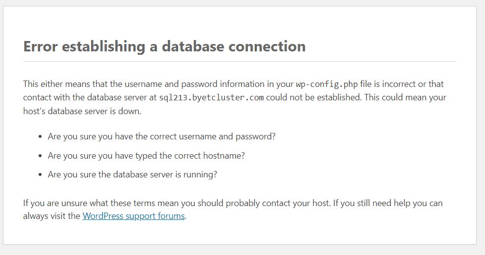

Right now, your site just says “Error establishing a database connection”, which means WordPress is unable to connect to the database but doesn’t tell you why. To learn why, you can enable WP_DEBUG mode: Debugging in WordPress – Documentation
With that option enabled, you should see a more technical error message. You should be able to find that error message in the article above. If you don’t, or if you have trouble making sense of it, please share the error message here so we can help you.

this is the error message I get sometimes when trying to go on the website itself:
