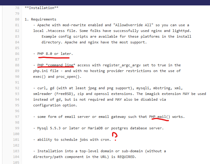

I don’t know how old version you have
but the last one requires php8
and a few more things that are not possible on this hosting. (e.g. cron every 15 minutes ?).

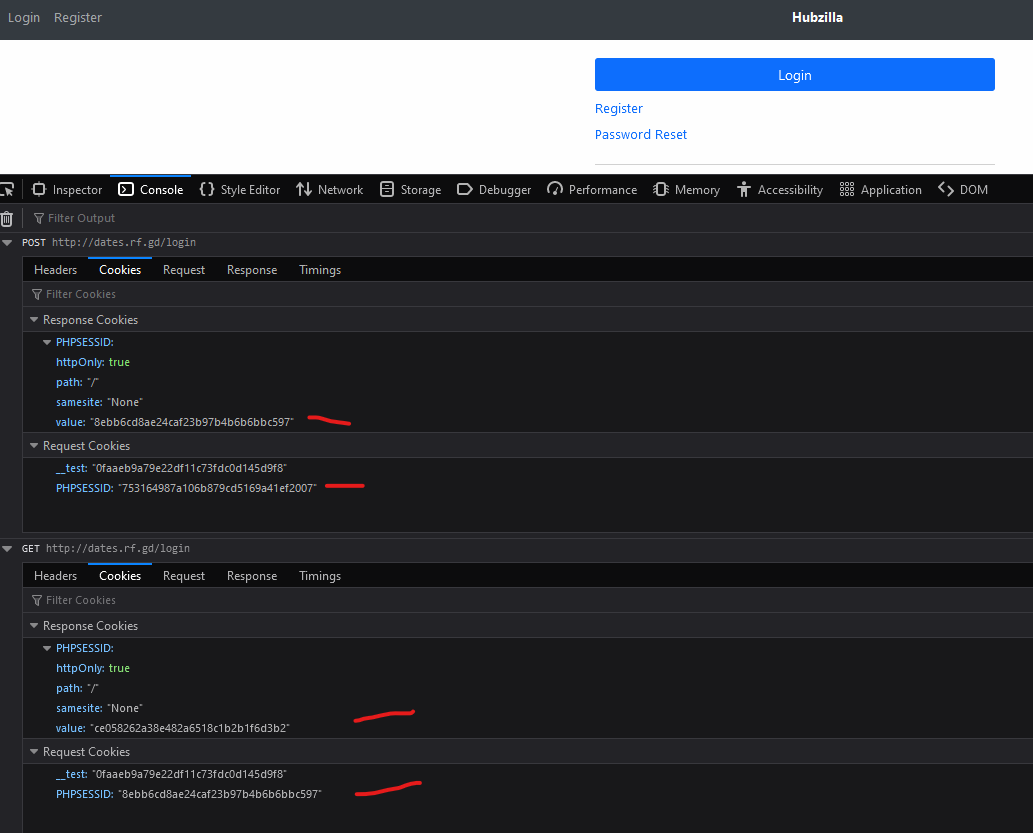

One thing I noticed that may or may not be the cause is
that the session cookies that are requested and that are returned do not match when the login button is pressed

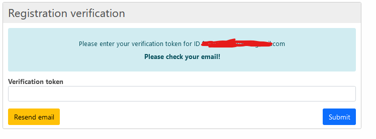

In addition, the registration does not work because it does not send mails because PHP mail is disabled on the hosting
so you have no use for that script if no one can register
Since registration doesn’t work, I can’t check what happens if I’m logged in
