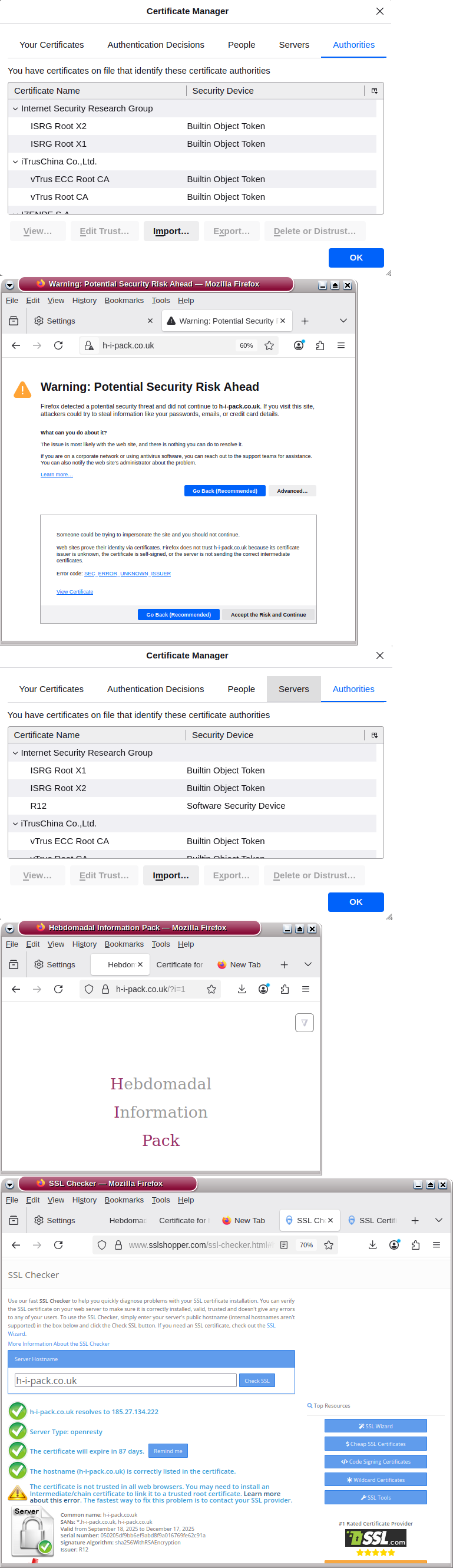

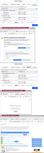

Images in order:
Initial ISRG certificates installed - X1 and X2 only
Then accessing https://h-i-pack.co.uk - error message
Imported R12 intermediate certificate
Then accessing https://h-i-pack.co.uk - OK
SSL check indicates that the server is not sending the intermediate certificate
