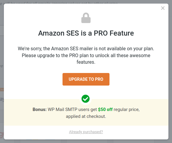

I believe your information is outdated. Amazon SES is non-available without upgrading to PRO. Therefore, I think I have drawn the right conclusion.
Screenshot from 2024-02-10 16-27-03
This is what I see

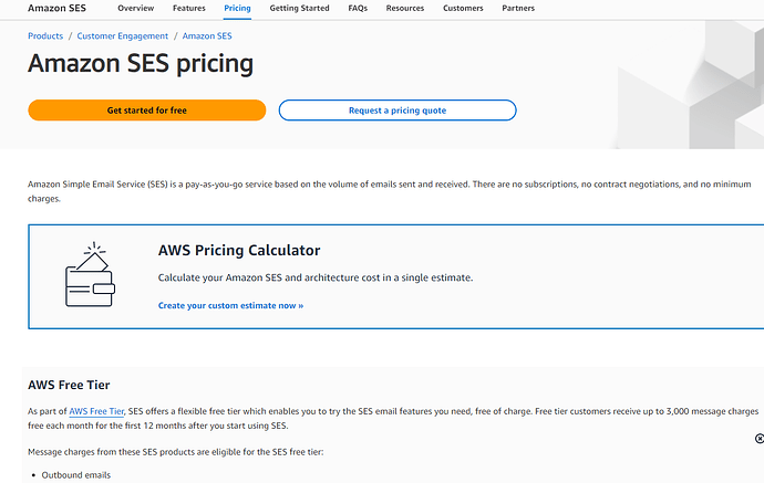

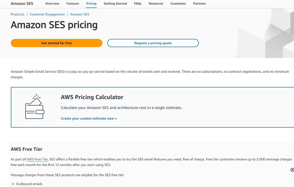

unless you are already on the free tier for more than 12 months…
When you have created an account with Amazon SES you should connect it with hosting that is not available on the free plan.
That’s the Amazon SES integration with your mail plugin. Your mail plugin wants you to pay them for that (Which you shouldn’t do as you can configure it manually). Upgrading to premium hosting would not fix this.
If you go to Amazon’s website, you’ll see the real pricing for SES. Then, you can get your SMTP credentials from Amazon, and configure the plugin manually with those.

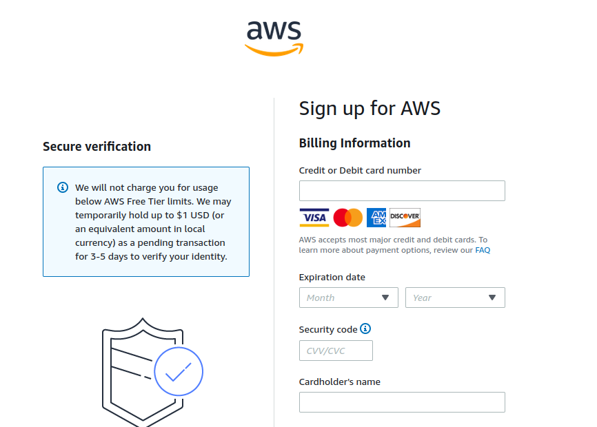

The option that requires entering credit card information doesn’t suit me. So I am posting a direct question on the forum, hoping to receive an answer that will help me. Thanks
Ok, what about other SMTP providers? They don’t all require credit cards.
I mentioned Amazon SES because it is one of the providers for which I know you only need CNAME records. You can integrate SES in your WordPress site with an SMTP plugin.
That does not mean you must use SES. We use SES here and we’re happy with it, but there are plenty of other providers to choose from. I specifically listed SMTP2GO as an alternative, and I know that they have a forever free tier.
