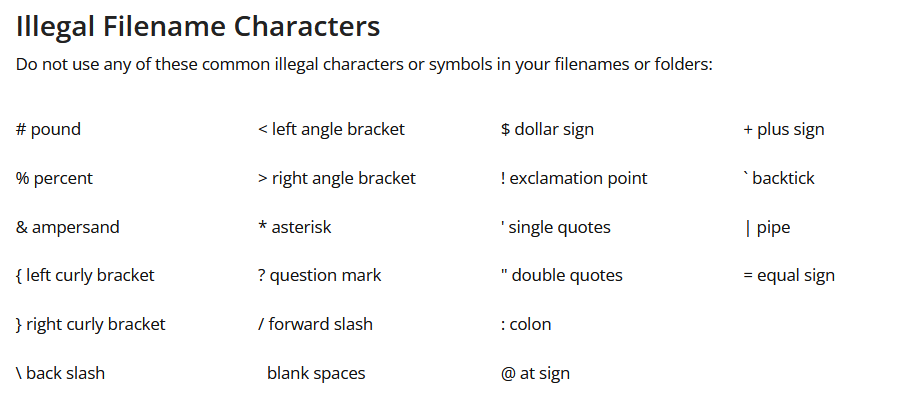

it’s best if you don’t name the files like this
(local lang)
1b
How to Name Files/folders
Do Not Use Special Characters
For best results, you should only use the letters a-z, A-Z, the numbers 0-9, hyphens (-), underscores (_) and periods (.). Any other character could get you in trouble, causing the file not to load or the page to load incorrectly.
it is best to use lowercase letters, also Do Not Use Any Spaces

i will fix image names with “+” sign, got only a couple of those no problem.

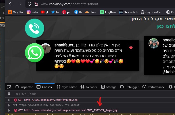

I tried that refresh thing tried even different browser and private mode still getting some of the images from the php not loading.
i am seeing their alt text:
seems like 503 error on all the images that dont load. what could cause the problem?
