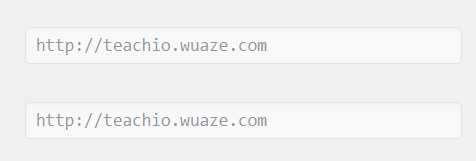

This means that visitors are being redirected to the HTTP version. I can see you’re using WordPress. Did you set your URL in WordPress to be HTTPS?
Thanks for the reply! I think this might be the problem but I can’t change it

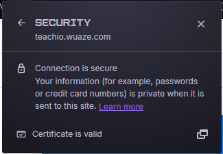

It looks to me like the problem is resolved now.
If you don’t mind me asking, what did you do to fix it?

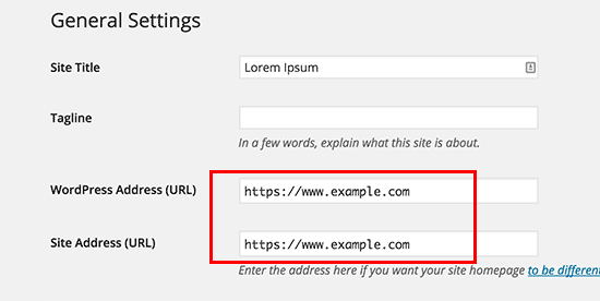

I was blocking everything with this two lines in the wp-config.php file. I deleted them and changed the settings in General, and now it’s working.
define('WP_HOME','http://teachio.wuaze.com');
define('WP_SITEURL','http://teachio.wuaze.com');
