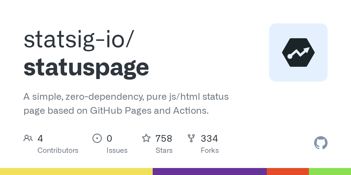

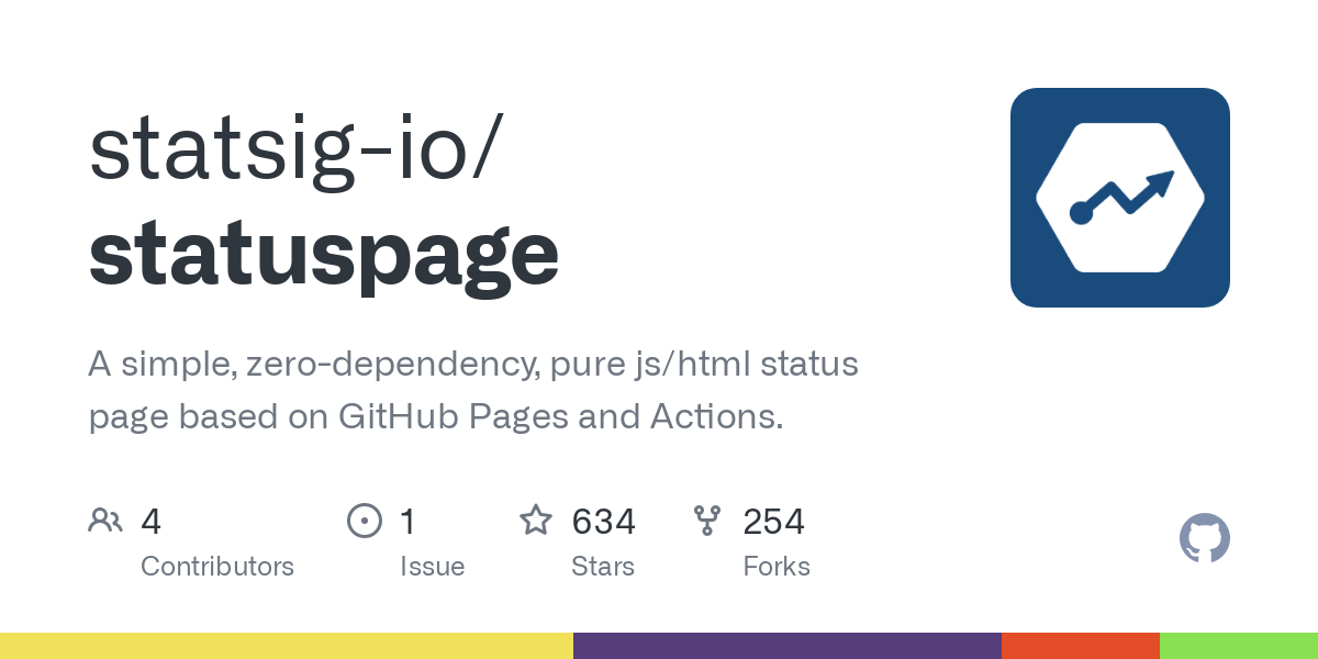

Here’s the github i forked for the health check up
The script named : healthcheck.sh at main directory of the script , running by a schedule health check using cron in .github workflow
