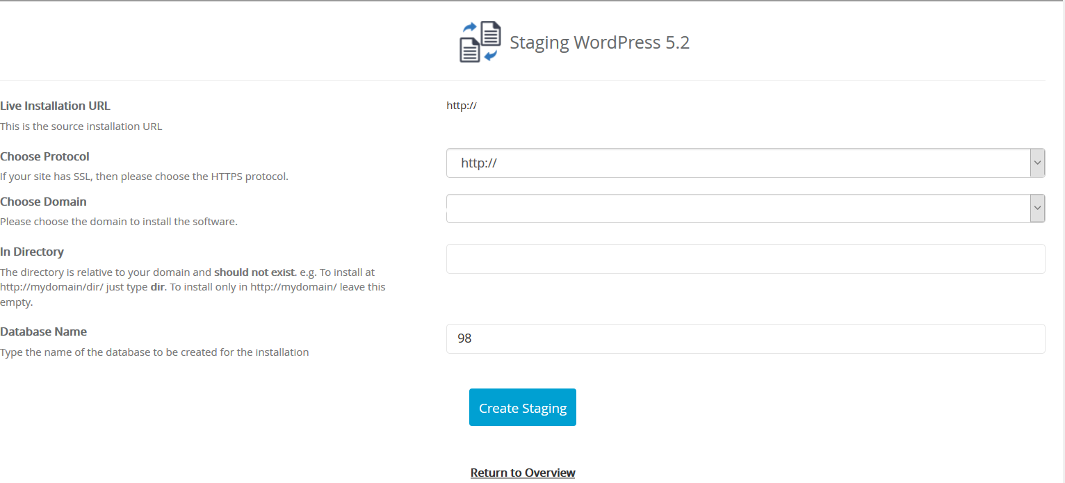

I wonder if anyone could explain to me what “Staging” means from the InfinityFree’s point of view? Is this for creating a test version of the same site?

Where do you see this exactly? We don’t have any staging or preview mode features as far as I know.
Here is the screenshot of the Staging page:
http://www.softaculous.com/blog/prevent-breaking-your-live-website-with-our-staging-feature/
Wonderful, that’s what i thought the Staging would be for. I am surprised that Admin would not know that. Anyway, your link will help me to follow all instructions without messing anything up. Many thanks!
I don’t know, too. I don’t know Softaculous having feature like that now.
