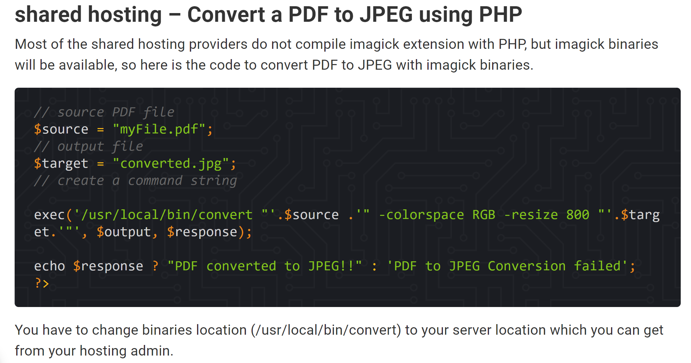

Many thanks for the reply! Also, Is there a way to check which libraries are installed on the server. I wished to convert a pdf to image but most of the php examples online use Imagemagic (or its derived form) library which I see in several Q and A on forum that this is not available on the server. Also, are you aware of any other library which could convert pdf to image format at backend using php script? Thanks in advance.
Create PHP file with this content <?php echo phpinfo() ?>, save it, and open it in your browser.
A quick Google search shows me some libraries but in the end they all use Imagick under the hood, which we indeed don’t provide on free hosting.
We provide the GD library for basic image manipulation, but I don’t think GD does PDF.
Okay! I see! Thanks a lot for the reply!
Do you/anyone know if the server has ghost script installed somewhere? ā€œlinux - Convert PDF to image in PHP without ImageMagick - Stack Overflowā€?
Or is this possible in infinityfree
We don’t have Ghostscript, Imagemagick, libav-tools or anything else that could be used for media/document transcoding. We also have all command execution functions disabled in case we somehow did have a program that could be used for that.
So I’m afraid that this is just not possible.
