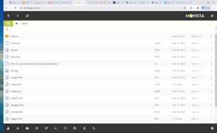

when i go to the home page all i see is the title and lower bar. There’s meant to be an image in the middle
when I visit internet-diving.infinityfreeapp.com/index.html I get just a blank screen. There is code in the file, I have checked. .htcaccess has the correct code as well
the files are in the correct folder, and not capitalised. I have tried clearing my browser cache, i have tried other browsers, I have tried different machines. They all come back the same
An HTML file should not be returning nothing, unless of course it’s empty.
Can you share a screenshot of your htdocs folder, and the contents of the HTML file and your .htaccess?
