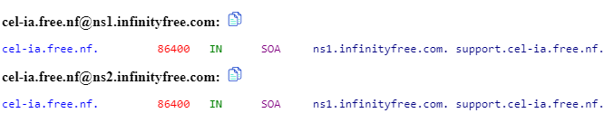

It is impossible to access my website. I have reviewed all the vPanel options and find no errors. I have tried to directly access the IP addresses using the url with IP and it is also impossible to access, therefore there do not seem to be DNS problems, it is probably access to the http server.
I see this

The particular records that were missing are caused by an issue on our end, and it’s not a setting you have any control over. By removing and re-adding your domain name, you’re forcing the system to recreate the missing DNS records, which will fix your domain.
However, as with any DNS change, the change isn’t visible everywhere instantly, it can take up to 72 hours for your domain name to start working.
The same DNS check that @KangJL did before now shows that the IP address has been set up. So basically all you need to do now is wait for your site to be visible to you.
