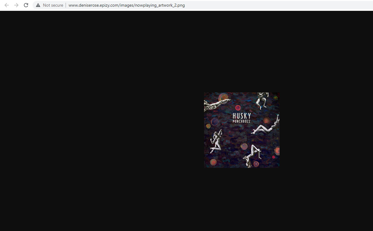

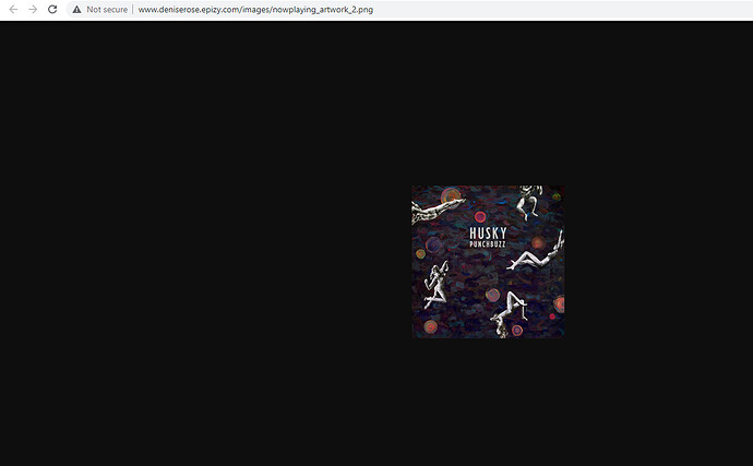

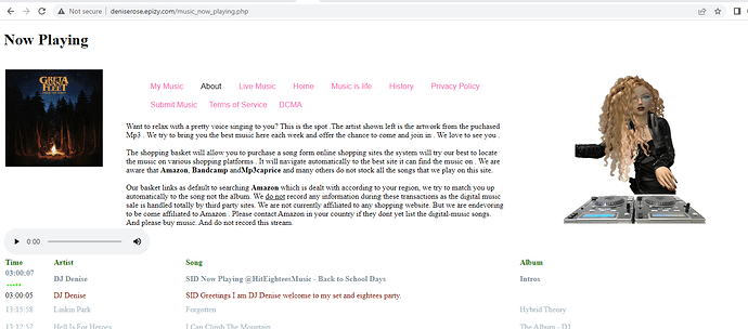

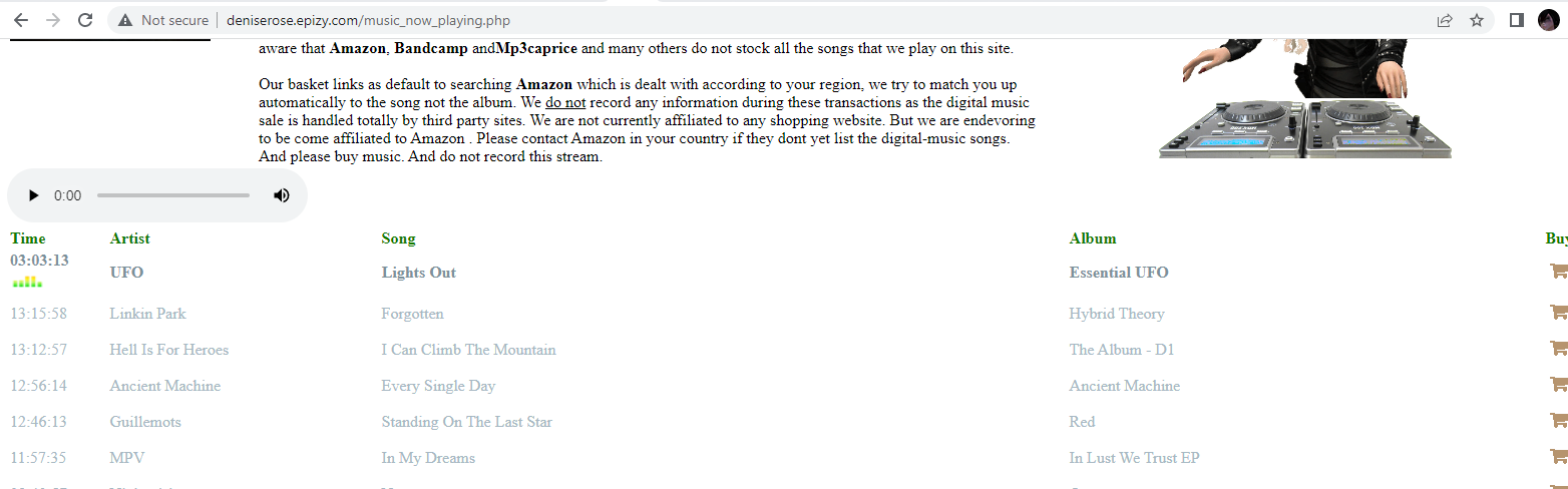

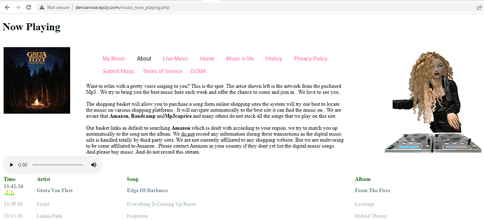

Well Its not true i had everything shut down it had all night to resolve it selvf opened up in chrome wrong like this
I then opened image from this page right click
refreshed this page
Went back to original refreshed that too
it does this on my fetch page too
running http://www.deniserose.epizy.com/fetch_sql.php You should not this has no scripts on it but does same not fetching image that has changed in your cache. I can in formed as for over complicating this most of it has run before on this other site who wont surrender my data legally as part of article 12/. There fore I am experiencing cost of my time .

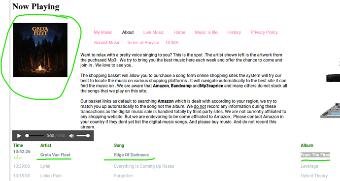

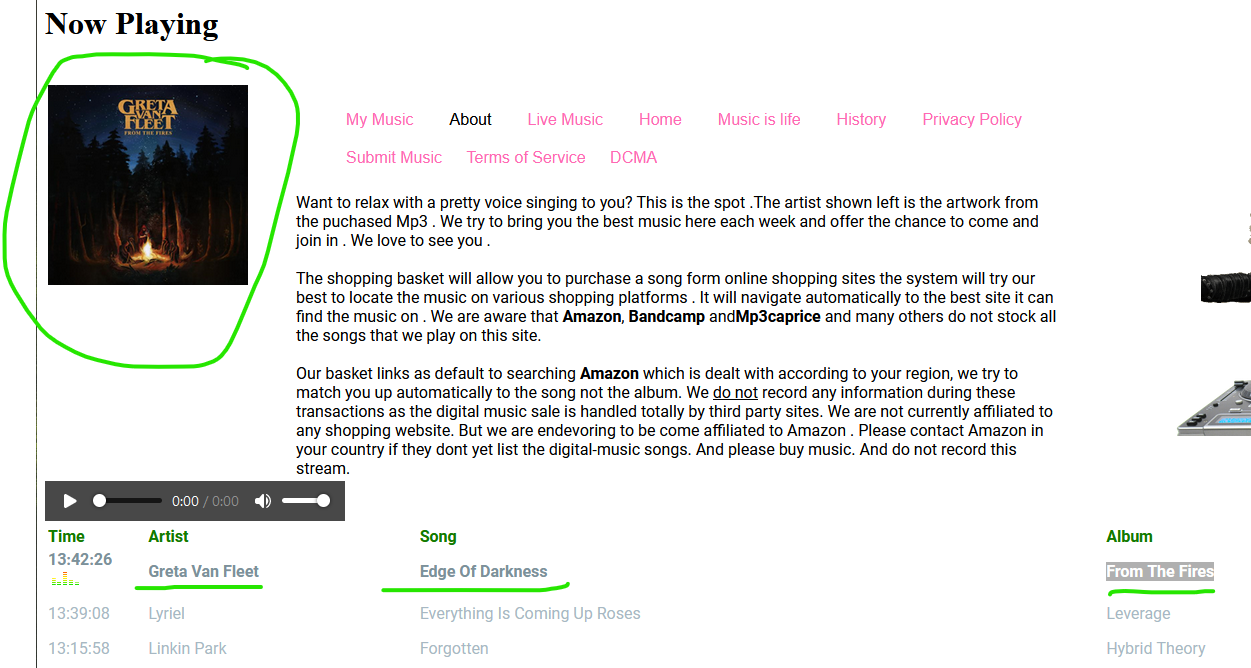

It is doing this every-time music changes which updated image by ftp as your write routines wont work from php see my previous post and will not upload and run fetch as far as I can tell . It looks at image on screen and image on disk to check they have same base64 they both according to f12 debugger come back with both empty even following an example Edwin did I presume this is as he is not using jscript in separate file . I cant get this to work currently even on these basic pages. As you system is not returning what i expect to give a base 64 string it says in debugger both are undefined . I did not understand what Edwin said next
My applications provide song art and uploads them separate with track info I expected my php code to do this but it fails with fwrite( as far as i can tell as I explained I am uploading this as ftp as it failed i don’t need to grab art else where its sent up by command to your sql service and server with add_track.php it just doesn’t to seem to work either as it appears your system is having problems locating image after it is ftp’d up to its location as your sysem wont support fwrite(
I don’t think i understand this sorry hugs D
the ahr ajax doe not do this
All file and sql are places on the system by add_track.php , however for some reason fwrite( is not supported and sdoesnt work so I am forced to ftp the image up to server location in /images/nowplaying_artwork_2.png which produces no error
my function in /js/fetch_updater.js in the debugger is loaded and run bbut does not provide base 64 information I dont know why

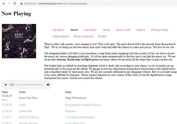

Everything I see here only strengthens my belief that this is just caused by browser cache. The fact that you could refresh the page to fetch the latest image means that the image has been correctly written to disk and is being served to the visitor browser if the browser requests this file, which it doesn’t because our hosting enforces quite strong browser cache by default.
I don’t see any evidence that your upload code is not working or that there is something wrong with the server storage.
The simplest way to fix this is to add a query parameter to the URL, and the easiest way to do this is through the PHP code. Simply having any query parameter will disabled caching functionality. So simply changing the code to this will result in browsers always downloading the latest image:
<img  src='images/nowplaying_artwork_2.png?version=latest' ...>
If you want to make it fancy and make sure you’re really getting a different URL each time, you could do it like this:
<img  src='images/nowplaying_artwork_2.png?t=<?= time() ?>' ...>
But again, this isn’t necessary because just having a query string disables all caching.
