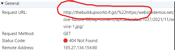

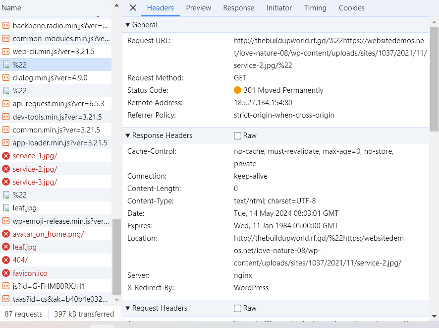

i am getting error 301 Moved Permanently and
404 Not Found.
Please check the website now. I am trying out all the themes, and this theme in the picture is working a bit better because all its images are stored in the media library. However, most of the themes, which have image URLs, are not working. They are giving ‘301 Moved Permanently’ and ‘404 Not Found’ errors. Please check the website now.

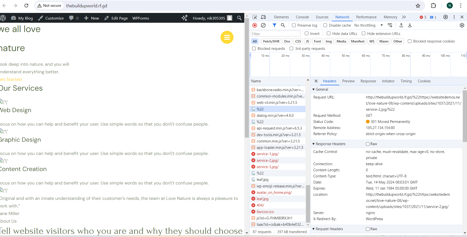

i mean this website http://thebuildupworld.rf.gd/ which you posted the pic of, now i have changed the theme again to which i am getting the error,
i wrote the issue clearly i am unable to load the images in my website which have image url and im getting the error They are giving ‘301 Moved Permanently’ and ‘404 Not Found’ errors. but the images in the media are loading fine like the previous them you posted screenshot of.

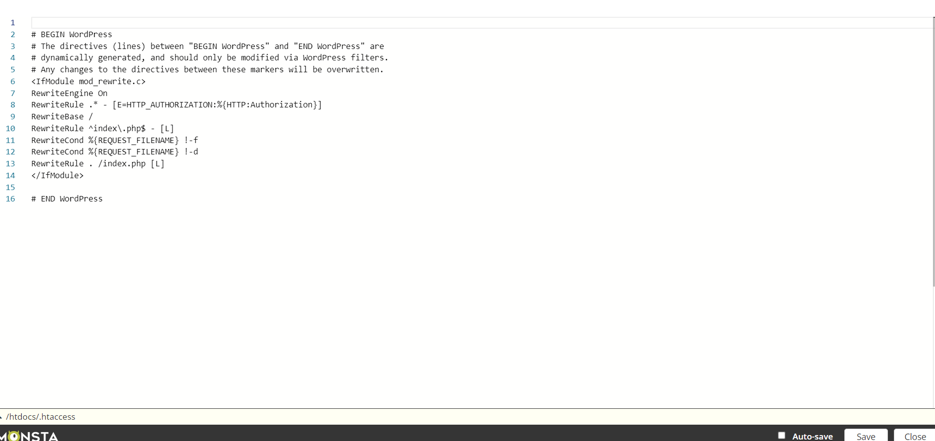

have you added any rules to your .htaccess ? check if someone strange is happening with that

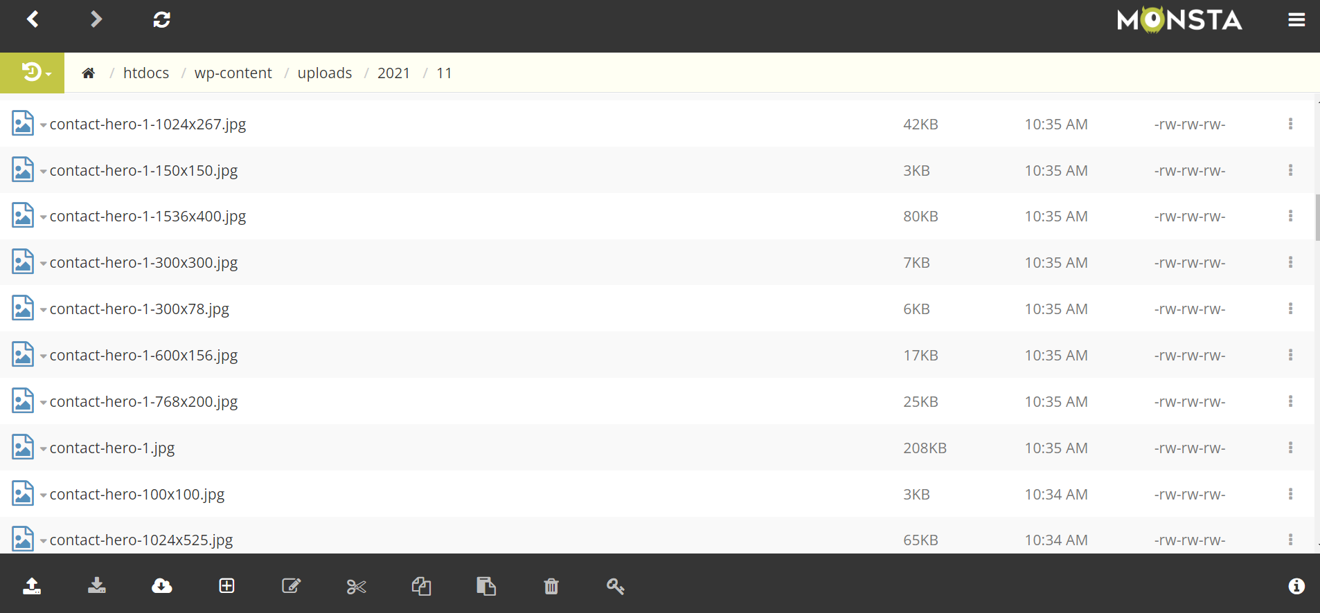

Your database is messed up.
Is this file present?
Yes, there are so many contact-heroes. How do I fix the database? I haven’t touched it at all. All I did was set up the website and then installed themes one by one to test them, but none of them worked properly.

What is the solution for this? It used to work before, but now I’ve suddenly encountered a problem. Because of this issue, I can’t use any theme properly. When I click on the link from the inspect element HTML, it directs me to this link: https://artup.rf.gd/"https:/websitedemos.net/dental-08/wp-content/uploads/sites/906/2022/10/testimonial-150x150-1.jpg/. That’s why it’s not working. But it should look like this: https://websitedemos.net/dental-08/wp-content/uploads/sites/906/2022/10/testimonial-150x150-1.jpg. In order for it to work, I’m not sure, but that’s what I observed. Is there any way to fix it? Because every theme was working fine before and the problem started recently, even in my new account where I have only 2 plugins installed
Looking at the raw source code of the generated HTML, there is a segment of code in the middle that contains a lot of wrong HTML code.
The content contains some classes that start with uagb-
, which a quick Google search tells me are part of Ultimate Addons for Gutenberg.
So my guess is that either:
- The page content of the home page is wrong, and some content got loaded in there incorrectly.
- The theme you’re using conflicts with the Ultimate Addons for Gutenberg plugin. Or maybe Gutenberg in general.
Looking more closely, I there are also references to Elementor in your page. I wouldn’t be surprised if trying to use Elementor and Gutenberg at the same time may also cause conflicts.
