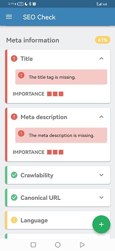

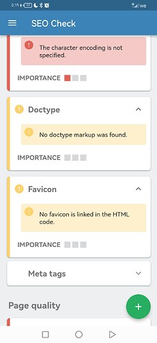

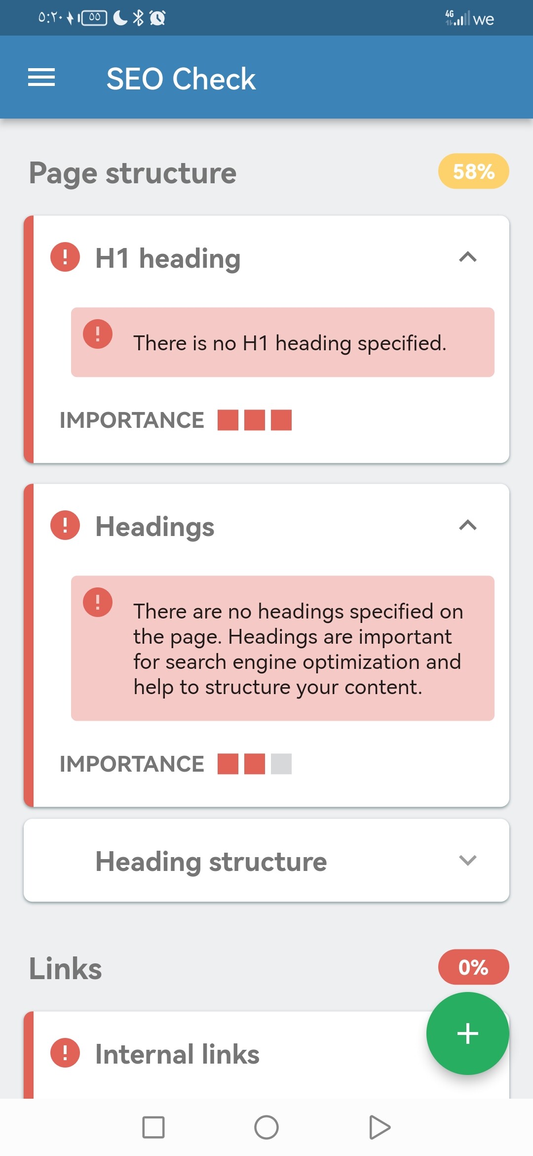

I have a website when i anlyze it with Rank math website it gave me 29% so i added seo code with all that missing elments in the screen pic but it didn’t Work so i decided to move it to wordpress and use Rank math seo plugin it raised to 57% but the same elments are missing

The Common Keywords you see in the report give a clue as to what’s actually going on:
You’re not actually running the SEO check on your website, you’re running the SEO check on the security page that’s presented to all visitors:
All of the SEO descriptions and headings and stuff not being found is not because they are not on your page, it’s because the scanner doesn’t actually check your page.
Don’t worry about the effect of this on SEO though. Actual search engine crawlers are a lot more sophisticated than any SEO checker.

The seo elments like h1 and h2 heading and meta description and Keywords
I have those all elments i want to those elments to my wordpress website
You will need to re-create them in WordPress

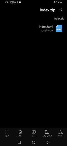

When try to convert my html to wordpress theme it says “folder not have any html” and i’m sure that i uploaded the right zip file the contains my html

Let’s clarify that WordPress themes although fundamentally HTML, are differently formatted files, meaning they have different sets of content from within the HTML files which you cannot simply convert or have a plugin to do so.
The above plugin is for those who have an existing made-for-WordPress zip package and would like to add that to the theme library, rather than it being so smart and being able to tell apart different sections on the existing HTML code.

As the admin mentioned before you can’t run an SEO check on your live site while it’s hosted on InfinityFree, as the security system prevents the SEO check tool from accessing it. But for the same reason, the low result does not necessarily mean you did anything wrong.

In some circumstances, perhaps. But for a site hosted on InfinityFree you’ll want to use a checker that actually offers a check that has a browser user agent with Javascript and cookies enabled, or by finding a way to do it to an offline version of your website rather than your live site.
