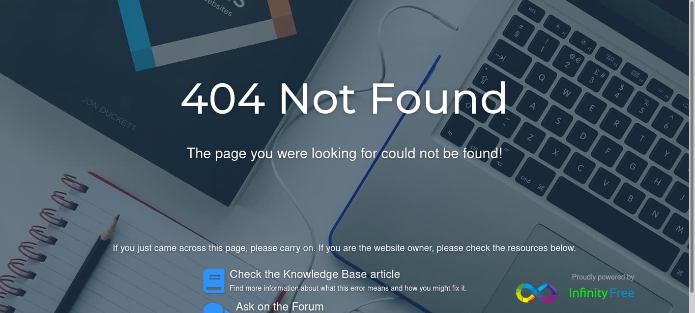

I own a domain called rohanpudasaini.com.np and added a subdomain on that i.e blogs.rohanpudasaini.com.np, but I can’t seem to access the subdomain.
I can’t understand what might be the problem so please help me.

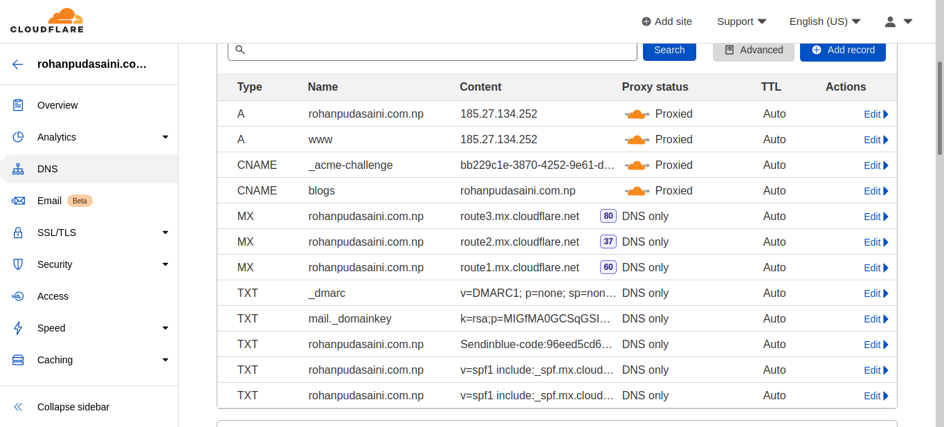

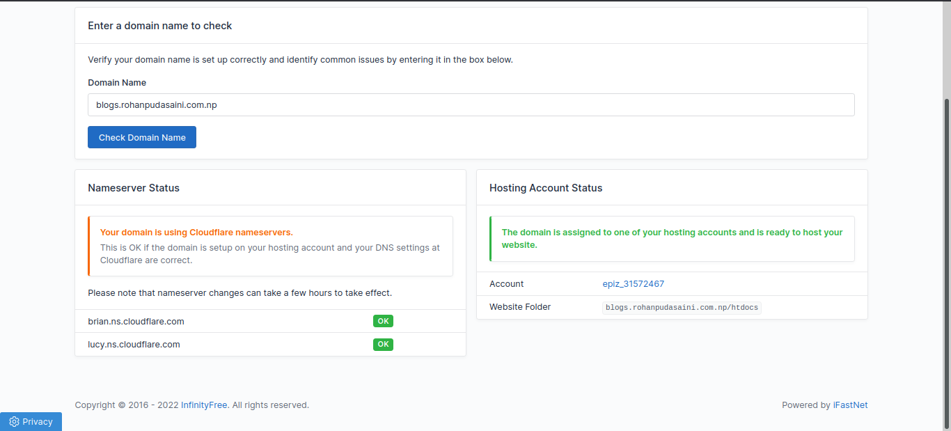

Can you do the following so I can help you out?
- Screenshot the subdomains panel in the control panel
- Screenshot your Cloudflare DNS records
Have you uploaded any files to the htdocs folder for the blogs subdomain?

If it does not work, change the CNAME records in Cloudflare to…
| Type | Name | Content | Proxy Status | TTL |
| CNAME | blogs | 185.27.134.252 | DNS Only | Auto |
Try changing the CNAME record then. It’s connecting to the server, but the server is not giving the proper information. Using the IP address of your account in the CNAME records should correct that.
Try using an A record instead of a CNAME one then.
it says A CNAME record with that host already exists. (Code: 81054)
