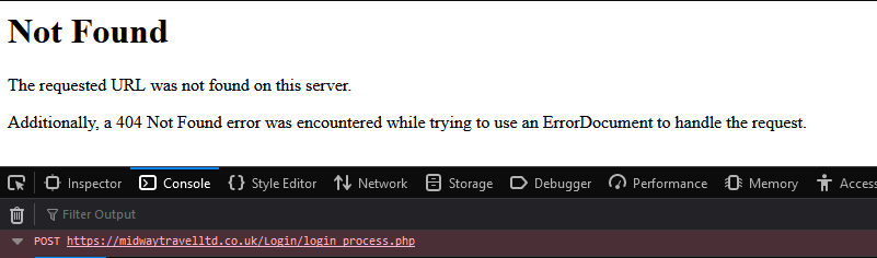

When I post request to the backend for a user registration or login, it responds with this… As I said, I am already using Cloudflare and Full (Strict) SSL… It works on my other backend and website…
<html><body><script type="text/javascript" src="/aes.js" ></script><script>function toNumbers(d){var e=[];d.replace(/(..)/g,function(d){e.push(parseInt(d,16))});return e}function toHex(){for(var d=[],d=1==arguments.length&&arguments[0].constructor==Array?arguments[0]:arguments,e="",f=0;f<d.length;f++)e+=(16>d[f]?"0":"")+d[f].toString(16);return e.toLowerCase()}var a=toNumbers("f655ba9d09a112d4968c63579db590b4"),b=toNumbers("98344c2eee86c3994890592585b49f80"),c=toNumbers("7ff721e48114e1c83894cfccf2858472");document.cookie="__test="+toHex(slowAES.decrypt(c,2,a,b))+"; expires=Thu, 31-Dec-37 23:55:55 GMT; path=/"; location.href="https://midwaytravelltd.co.uk/API/v1/?i=1";</script><noscript>This site requires Javascript to work, please enable Javascript in your browser or use a browser with Javascript support</noscript></body></html>
I am thinking it’s to do with the “?i=1”, however on standard browser I don’t get the “?i=1”, so it could be some cache or something…

This file that is called (POST) from the Login page does not exist
It’s not the main part, it’s the backend part, where my iOS and Android app communicates and authorises people.

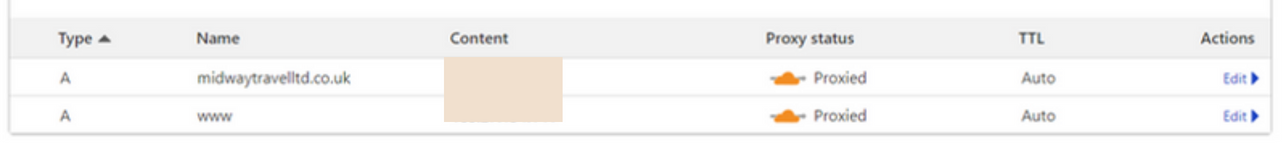

Here is an image of the CF DNS settings :
That’s what I think too. Your DNS and Cloudflare settings seem fine, but if you only just switched to Cloudflare, your mobile app may still be connecting directly to our servers, which is causing the issue you’re seeing.
