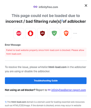

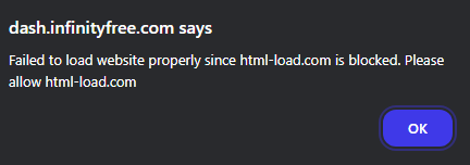

I followed the so-called “Troubleshooting guide” but it didn’t work. I’m on the Brave browser but even with shields down its still broken?? What is this??
I’m really confused with this free hosting, it’s something new everyday ruining the site.
There is an ongoing adblock recovery test on all the websites belonging to InfinityFree (main, dashboard and maybe even our Control Panel) that allows ads to be shown even with adblockers enabled. So I’m sorry to say that to support us you have to disable it. If it still doesn’t work, even after your adblocker is disabled, you can try changing browsers.
Sorry? I’m not changing browsers, i have shields and no adblockers plus I followed the troubleshooting guide. I support this site enough by fkn using it
The error is generated if the html-load.com script cannot be loaded. Usually that’s caused by an ad blocker, either built into your browser (like Brave Shields) or a separate extension.
If you have any DNS level ad blocker, that could also be blocking html-load.com. This could be something you configured yourself or something setup by your network administrator or ISP.
The popup itself is generated by an onerror function on the script tag. So it’s your browser that determines that the script could not be loaded.
Regardless, the html-load.com script must be loaded to be able to access the CSS of the page, so if it’s blocked, it will break our site.
I don’t know what’s blocking html-load.com on your end, all I know is that it’s blocked. If you tried the troubleshooting guide, or if you don’t have an ad blocker in the first place, you can try reporting it to [email protected], like it says in the popup.
