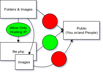

Even if file.php is allowed to access your images,the public still can’t view your images because their images request (by browser) are your original images URL.
This is its diagram:
But after I tried (trial&error),I can make the images viewable using .htaccess+PHP.
